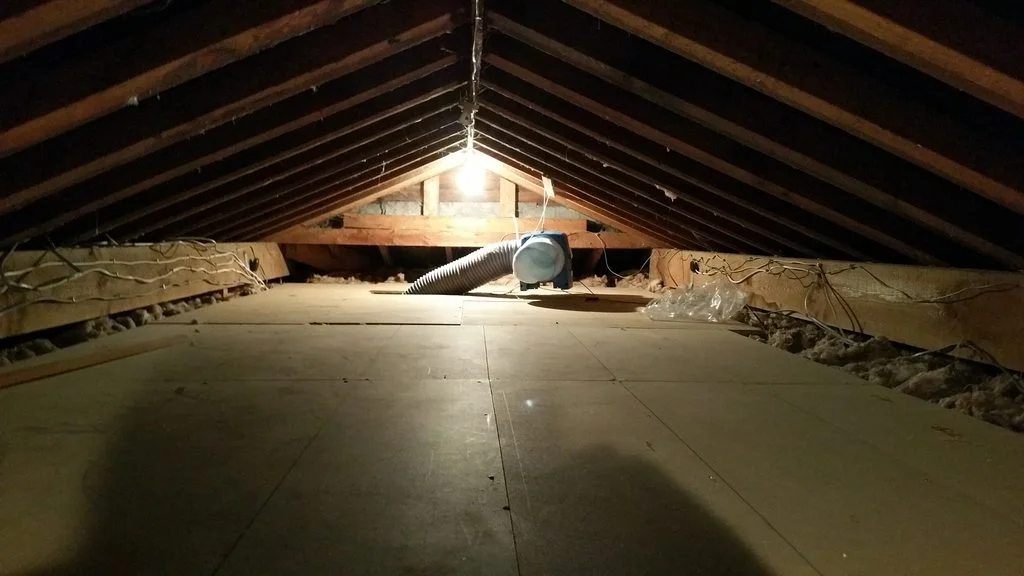

hah 3 layers of tiles only in the walls of the bathroom... Which I've not done yet
You can only hear the drimaster running if you put your ear up close (with the fan on a high setting) when you're in the loft. Otherwise it can't be heard at all from beneath, it's suspended from a cable to the roof trusses, so no vibration/noise can easily be transferred.
Image of install here: oqbpfbph.jpg
It hasn't created any noticeable drafts, and mines installed in a narrow corridor, which is the worst kind of installation point (near walls)
In terms of humidity it has significantly reduced the humidity issues in the bedrooms backing onto the garage walls. If I leave the doors open will be around 60% measured from hygrometer, was previously 80+% (roughly)
-Humidity will still get high ish in the nights when sleeping, but will be resolved just by leaving the door open which suits our lifestyle (both at work all day). I expect the humidity to improve even more so when I get a door between the bedroom hall and the kitchen.
I've been installing roof lap vents in the loft the last week or so, as the non porous roof felt has been condensing a lot of water in it, due to the additional heat in the house with the increased insulation (which I made sure to leave gaps at the eaves!). I've since resolved this issue with roof lap vents thankfully, very poor quality old bitumen felt.

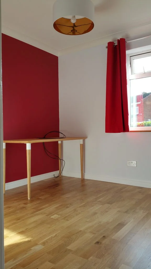

Finally have a 2nd bedroom/office. After routing cat 6 ethernet behind the skirting board I now realise why wifi was invented.
Also plastic skirting board was a bad choice... But done now :x

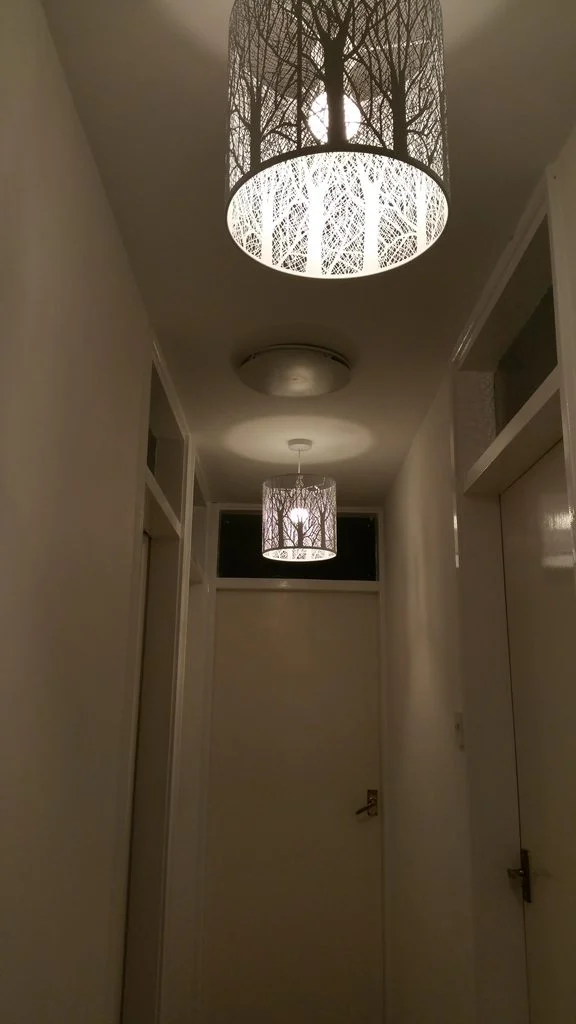

Here's underside of drimaster
Unfortunately one of the wall plugs to fit the unit to the ceiling hasn't worked on that front right corner (not that you can really tell). But it's on the list of jobs to do.
Yeah it's good, as said above. The positioning could be better (not much I can do with the given layout) and I'm yet to get a door on the hallway, which I expect will improve bedrooms.

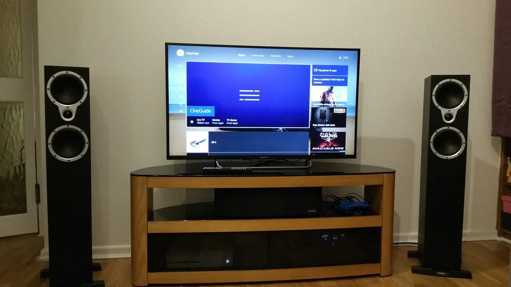

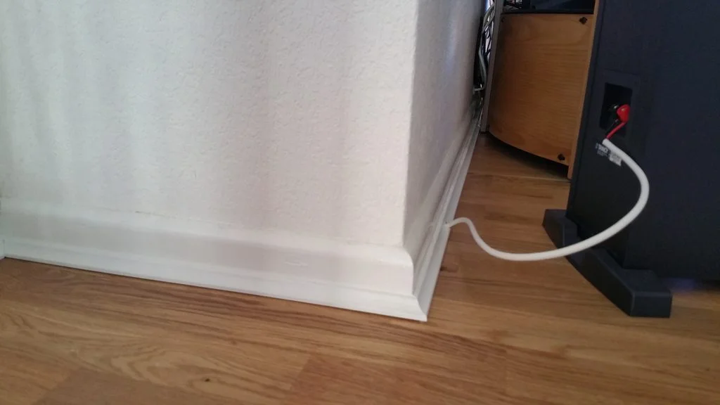

recently finished off the living room (ish)
Got curtains
Ran speaker cable and internet cable behind scotia (now it's fully hidden) - I realise this cable is a bit long! but easy to cut
fitted scotia
bought a tv unit
Considering whether to insulate internally the next bedroom which I'm going to renovate which backs onto the garage... But not sure if it's worth the bother really.

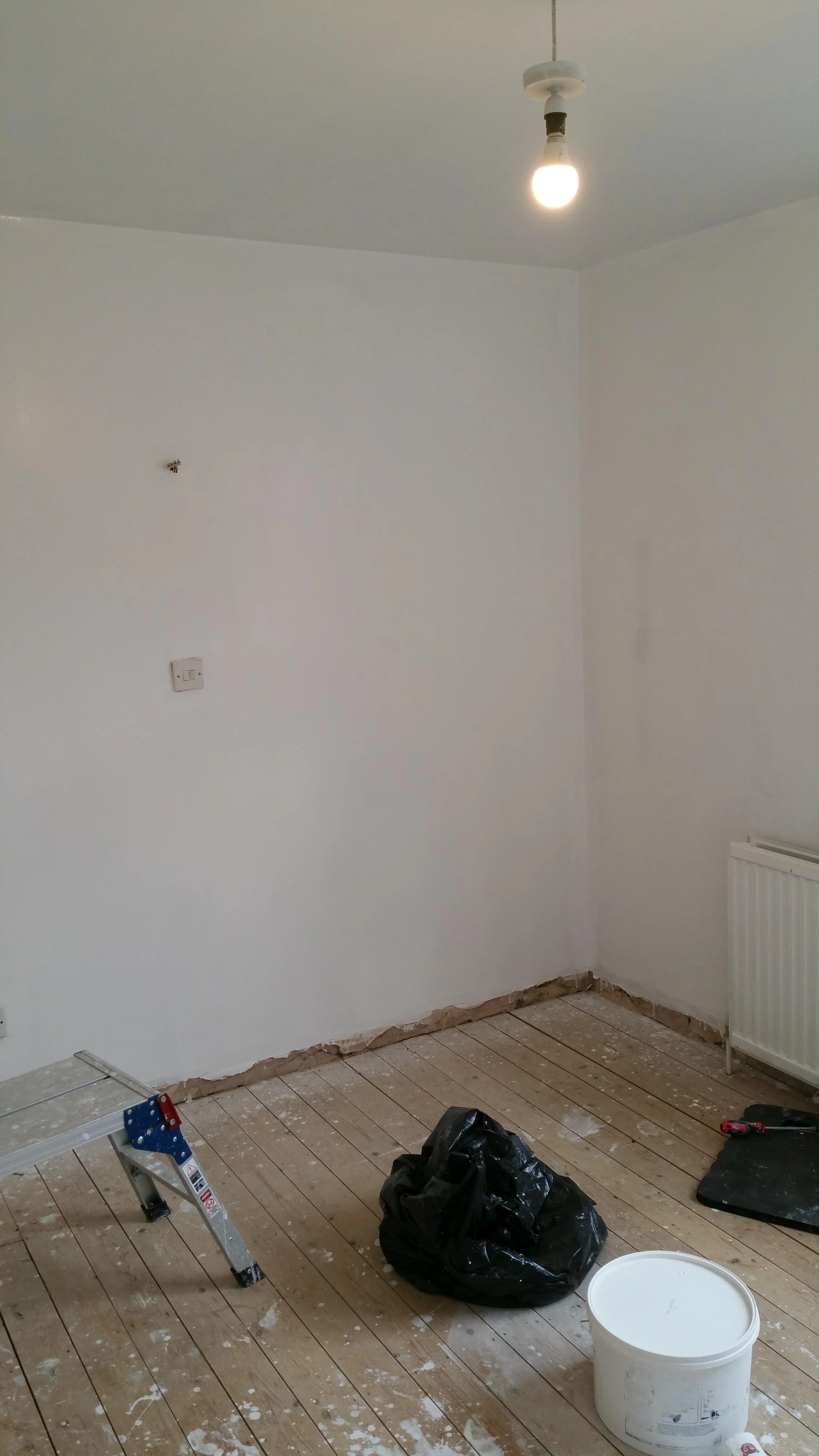

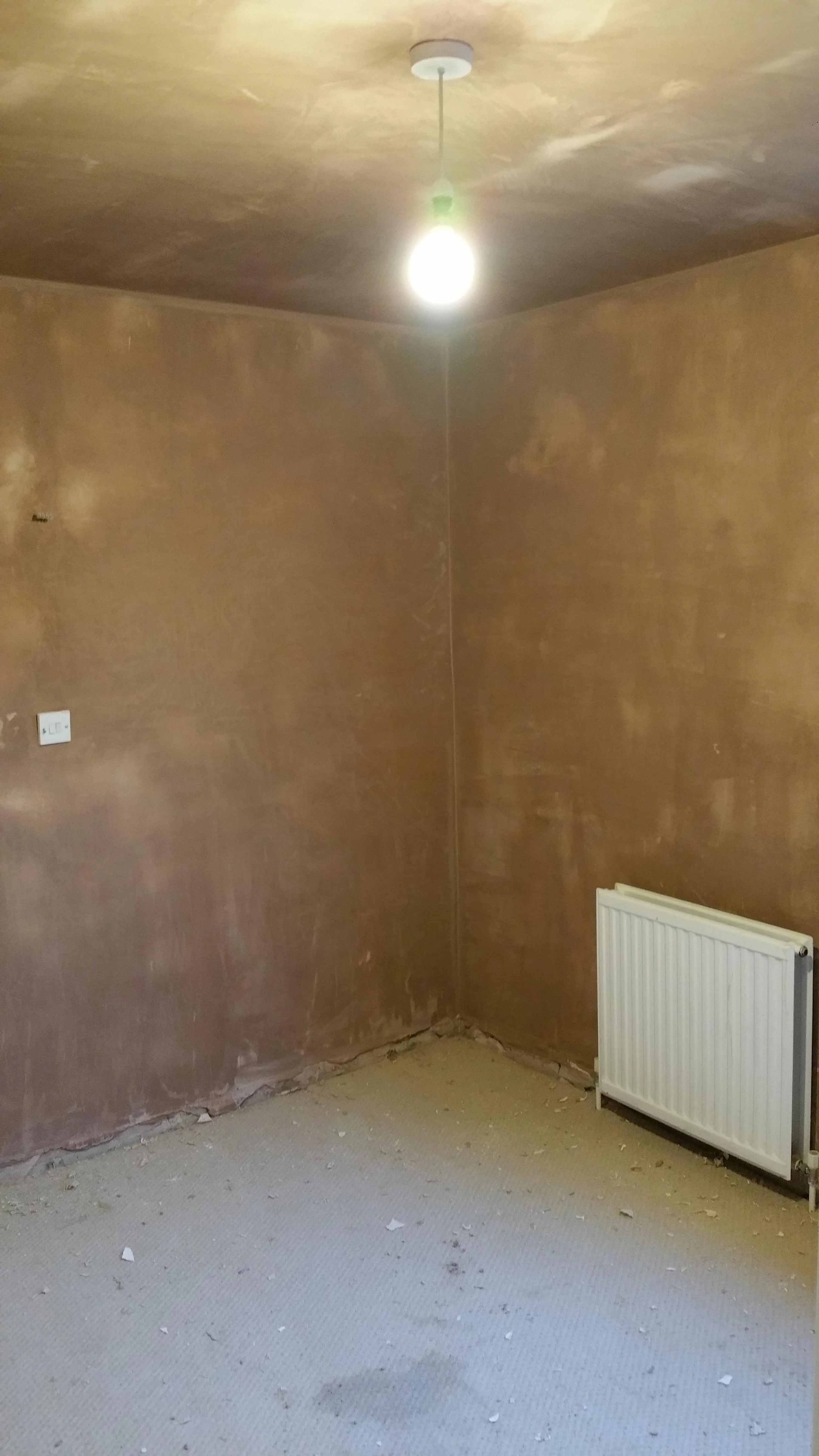

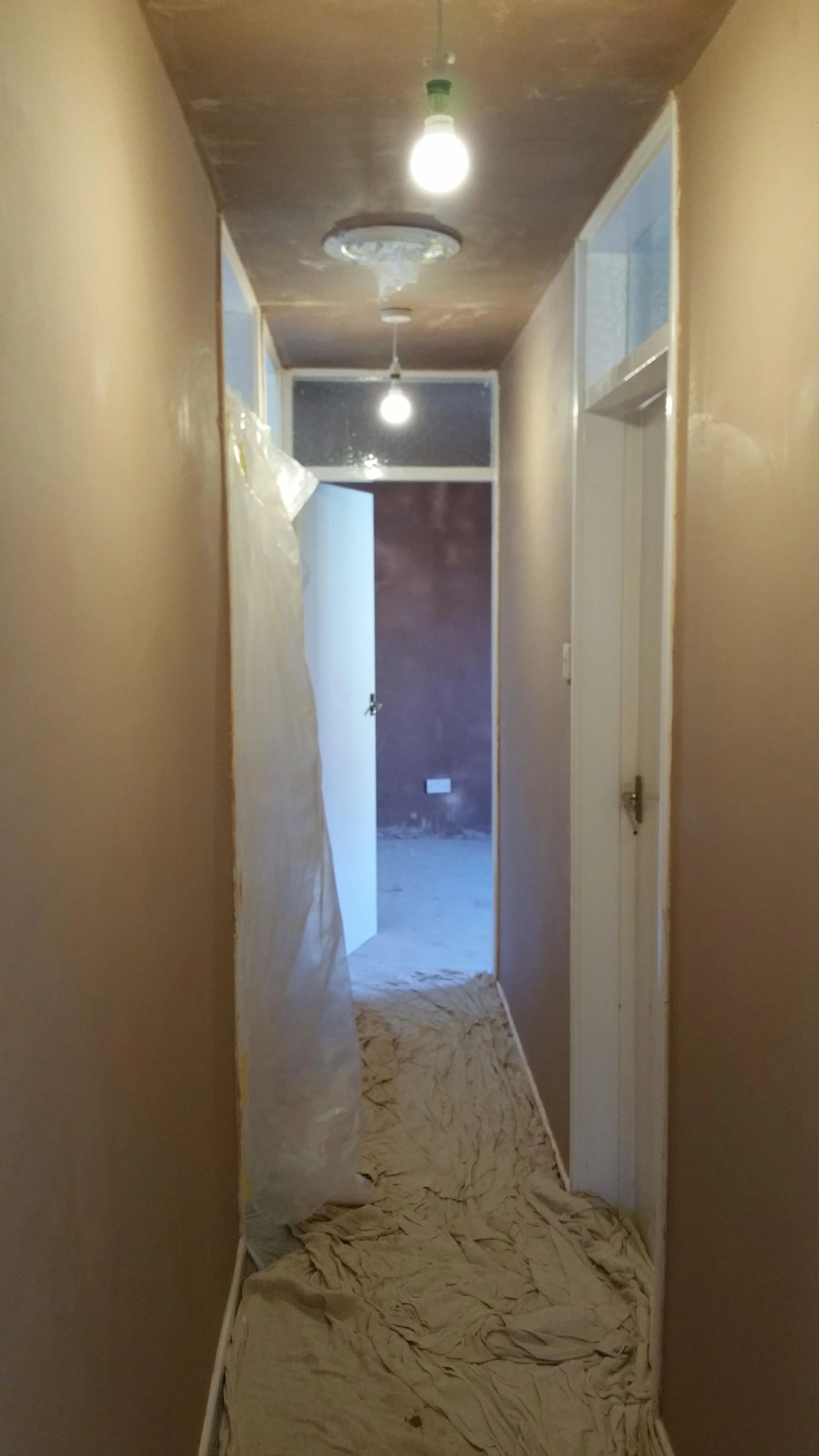

Recently:
Got the 3rd bedroom and hallway skimmed
(the hallway was previously done... But it was really bumpy from being mostly poly filla!)
3rd bedroom also had some old wardrobes in round the corner behind.. Which I've since removed. Was quoted £1k from an independent for some fairly standard fitted wardrobes! Thus I'm going to ikea..
and painting after the plaster dried.... Thus far, got a fair few coats to go!!

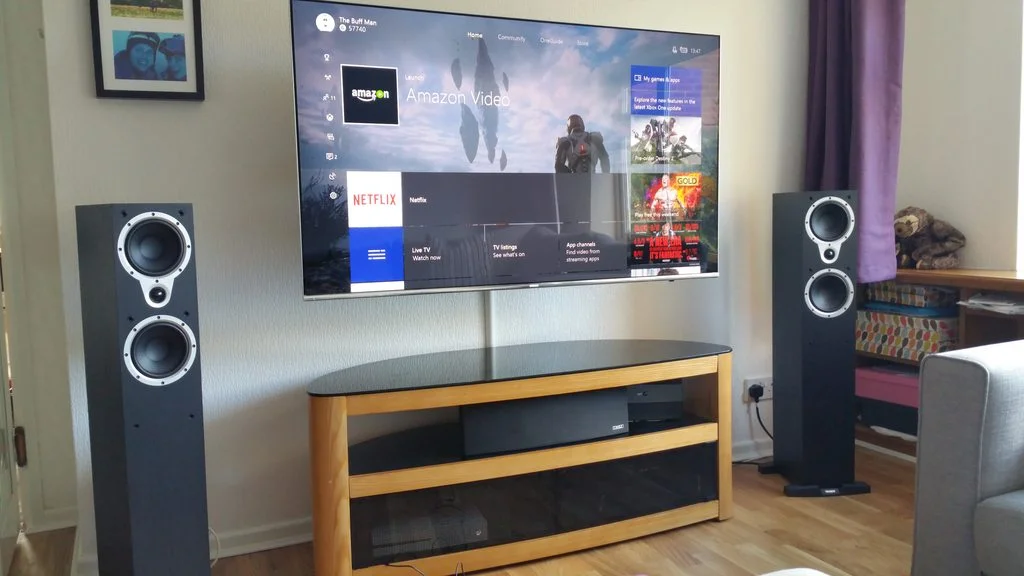

Wall mounted a new TV (thank the Lord for solid walls!)

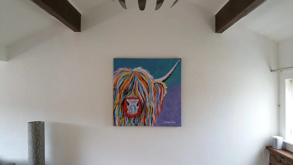

Also got a new painting

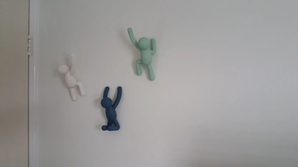

Also got some hangers for putting coats on in bedroom

They're Umbra coat hangers I got from Amazon :)

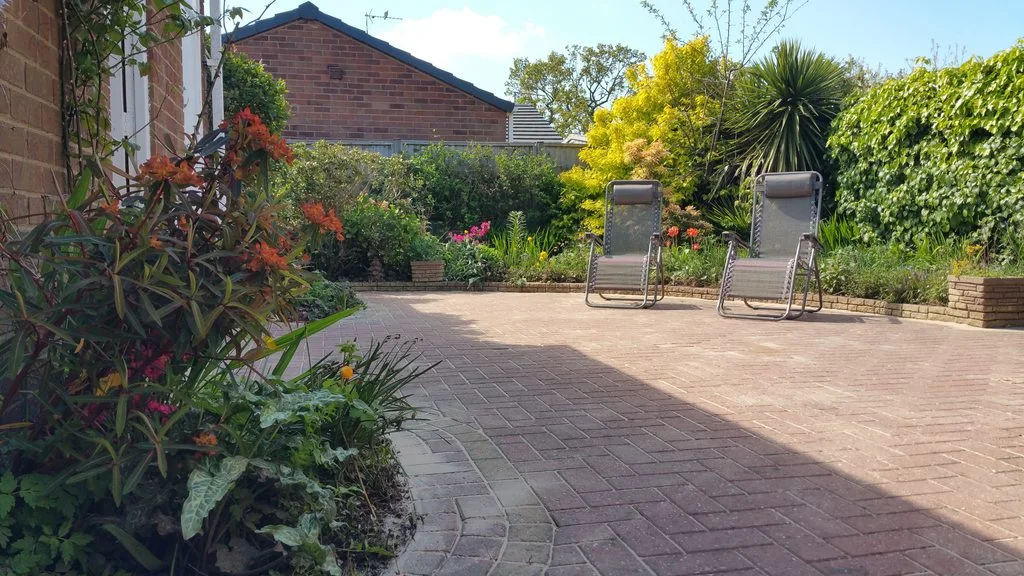

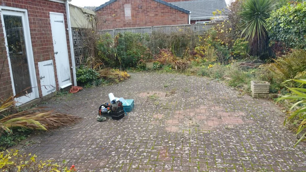

Been doing the garden, took a lot of jet washing and cleaning! Also levelled out some of the stones today (broke out and re levelled)
Before picture from December but gives an idea of the growth!

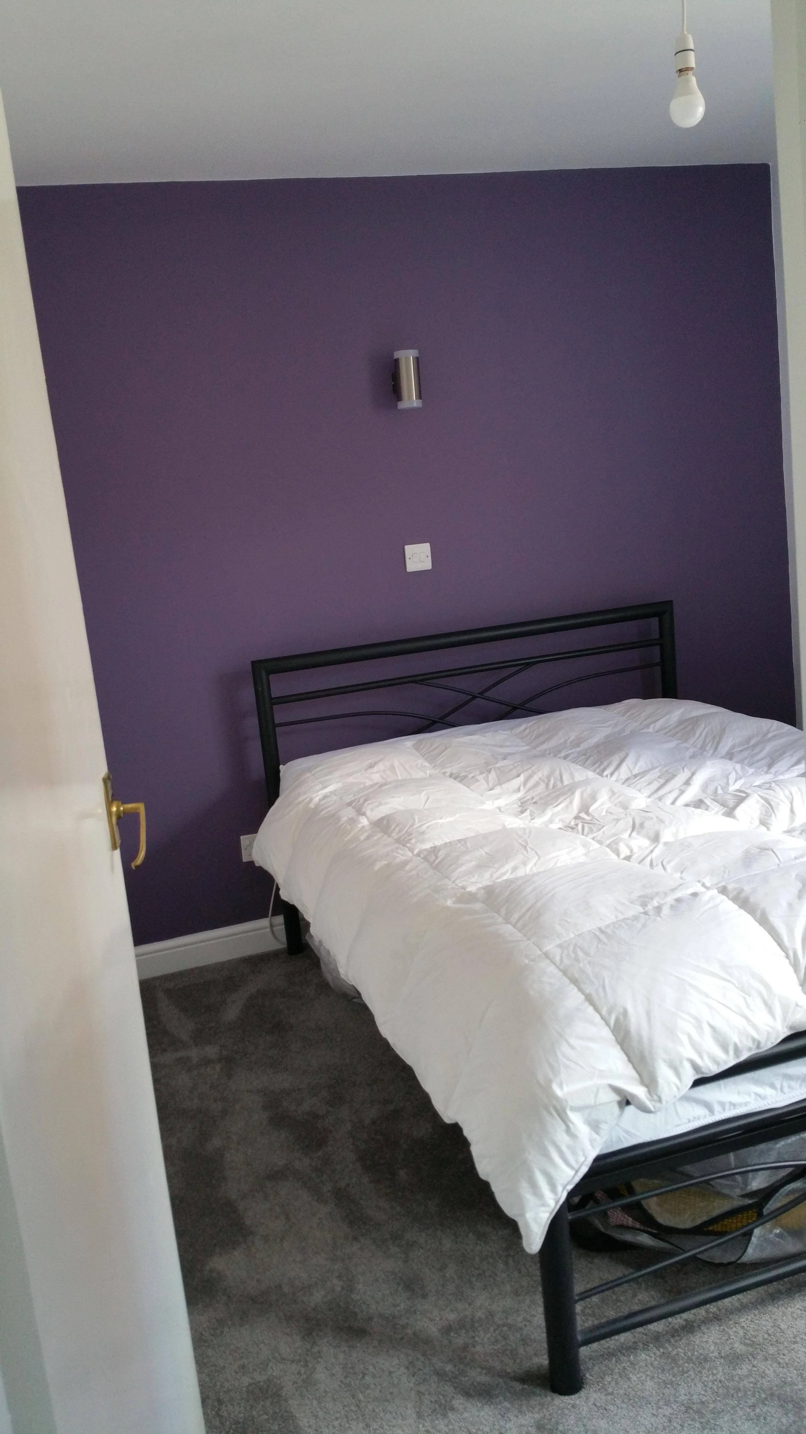

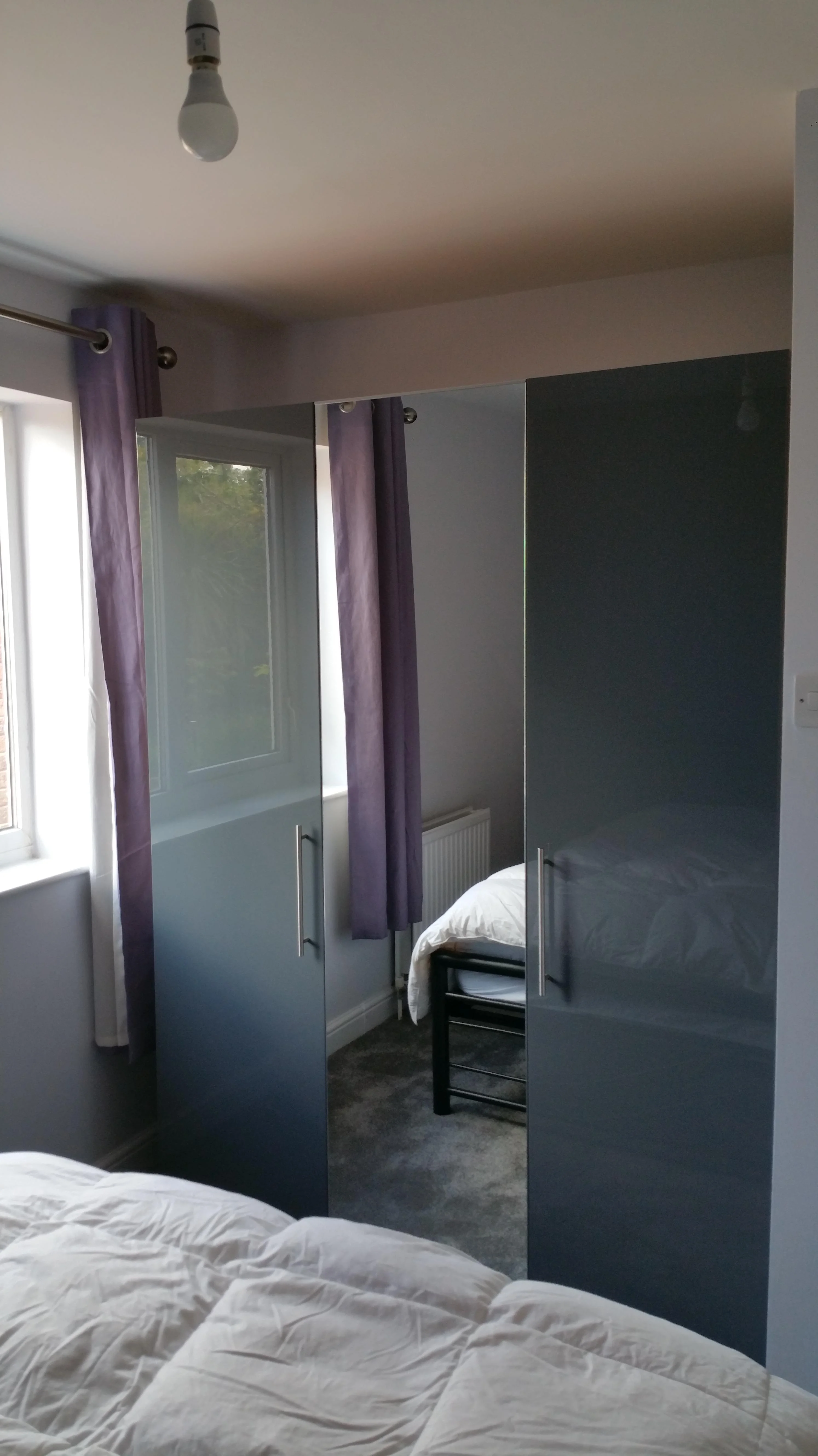

Finished spare bedroom (thanks to thread here fixing the electrics!). Just need to put covers on and a light shade
Also got some new wardrobes, carpet, curtains in spare room.

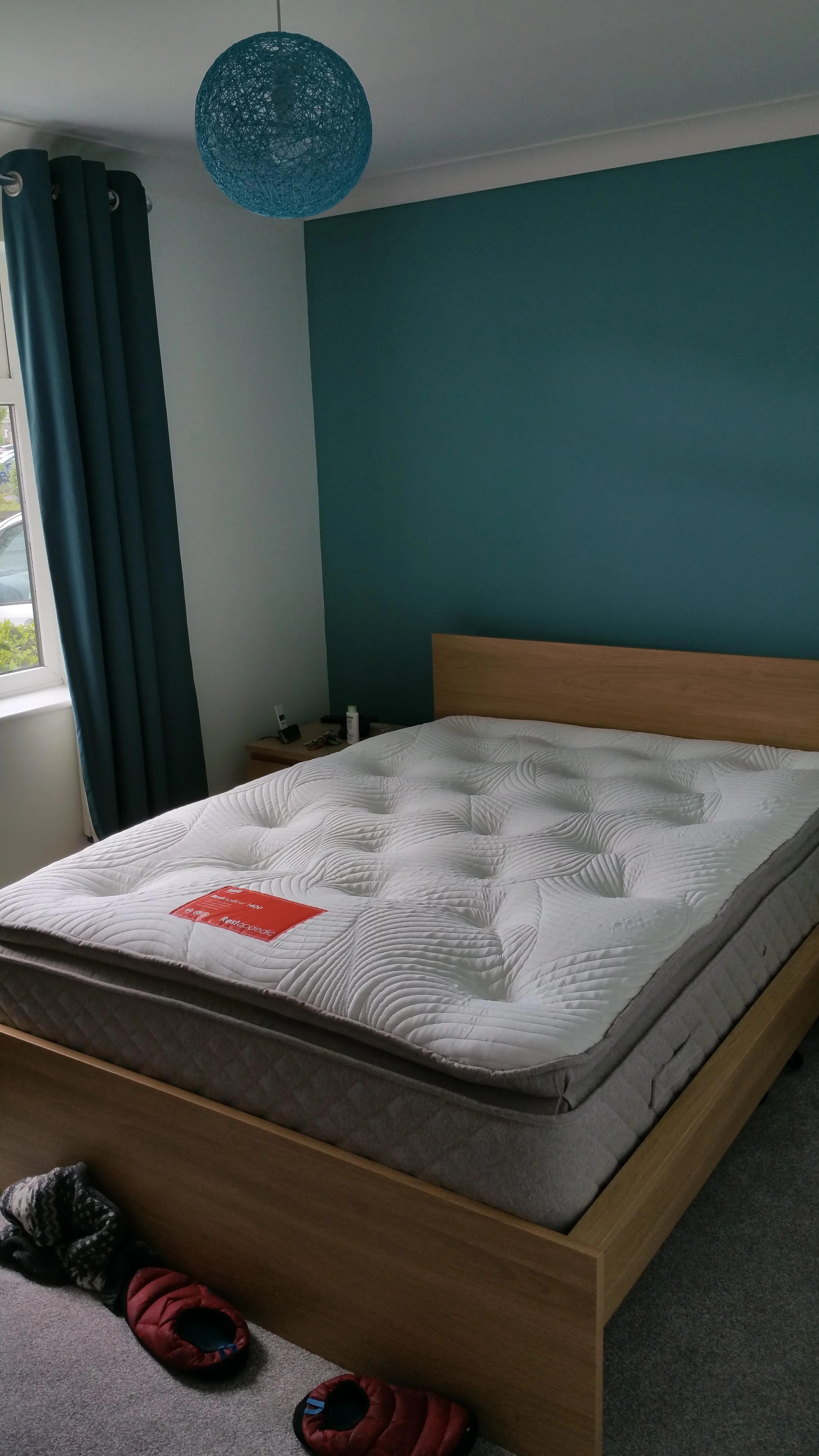

Also got a new bed and mattress in our bedroom

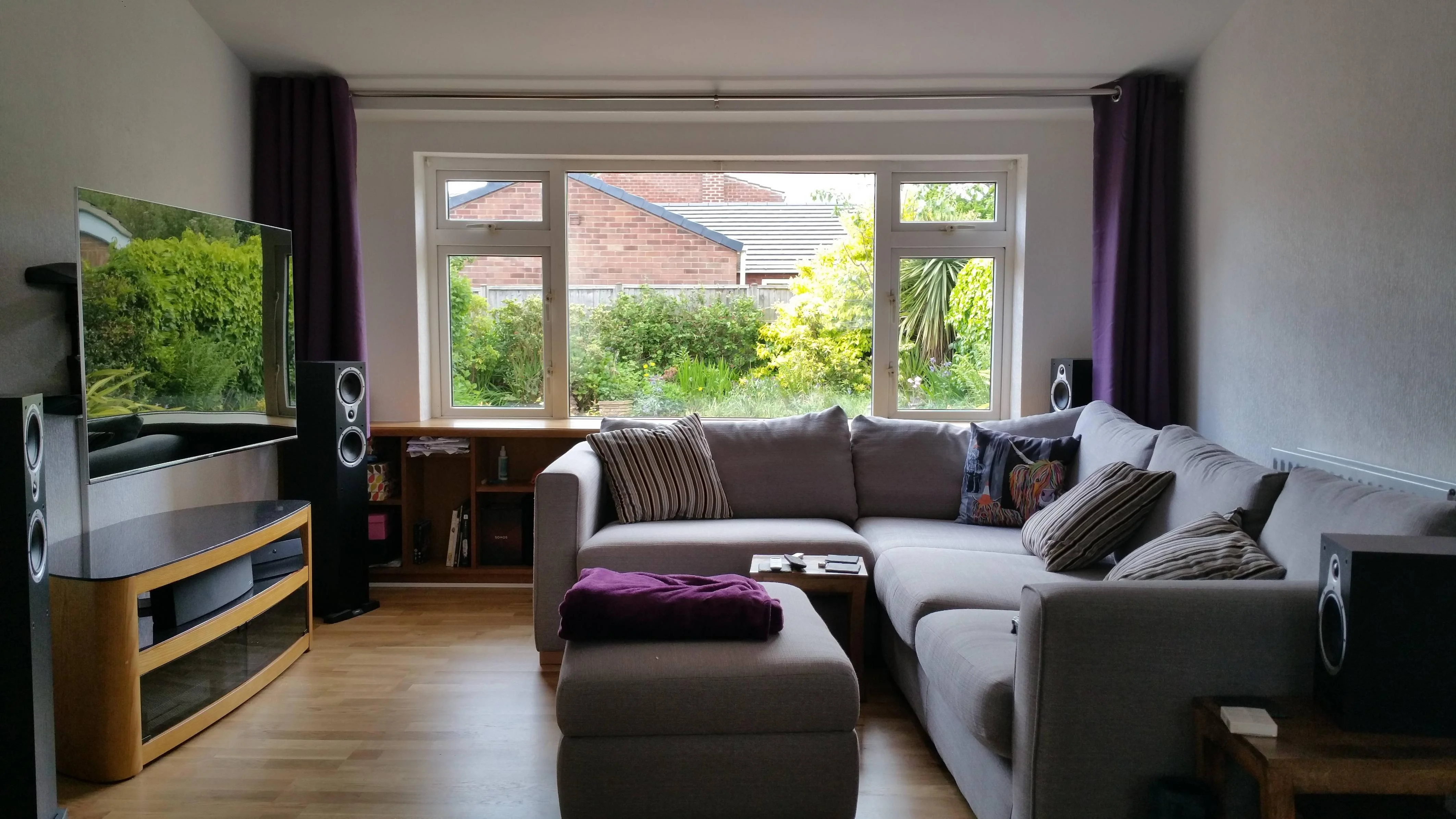

Some new cushions and a speaker stand for the back left. Been grafting / de Weeding a lot of the front garden but dont really have pics. Going to put 4 in 1 seed down to get rid of the moss/improve the lawn.

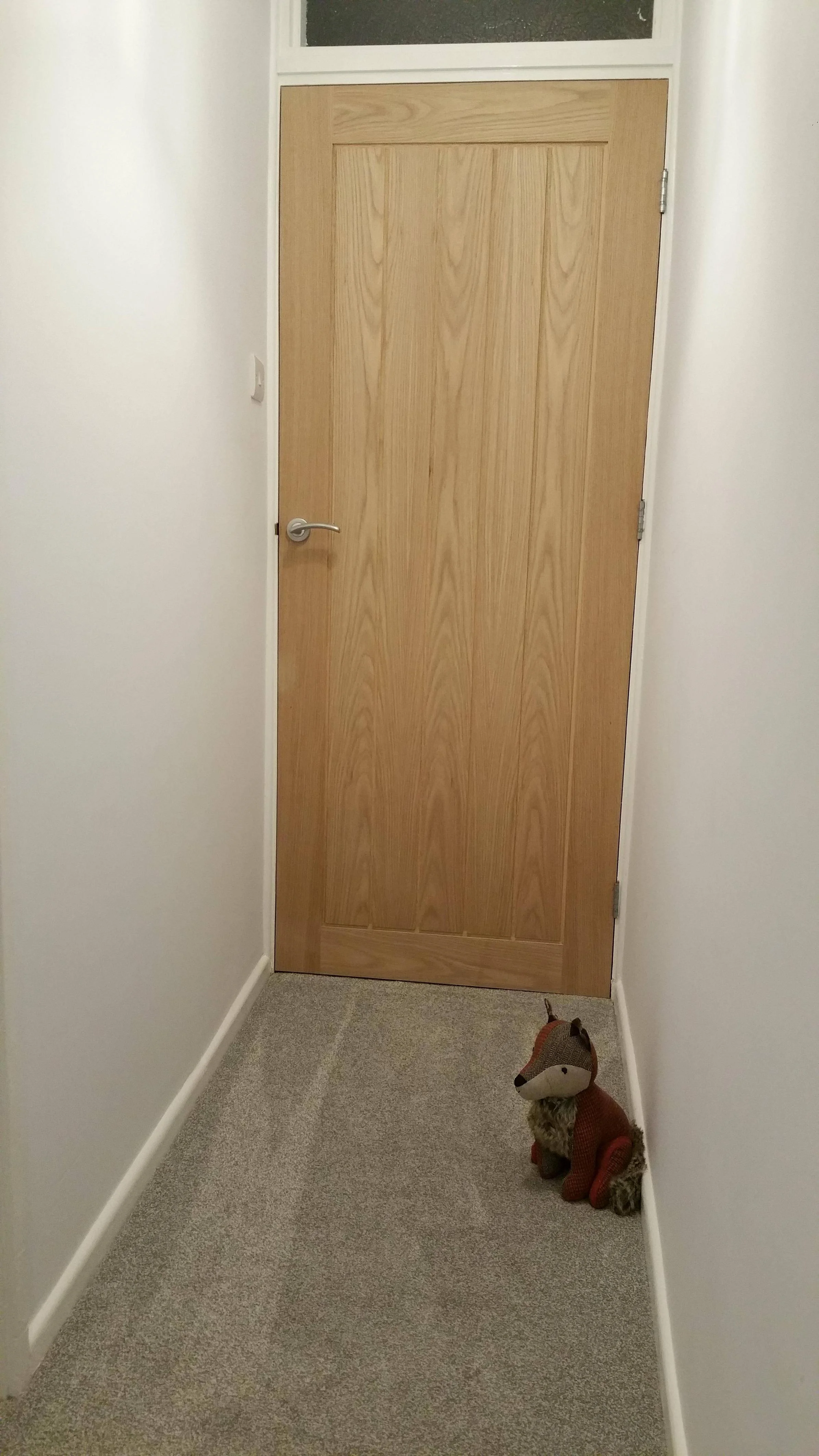

New door, carpenter said it was the hardest door to fit he's had in a while! Glad i didn't do it myself.
What would you guys recommend for finishing it? I've heard osmo oil is good? Would it keep the door colour similar?
