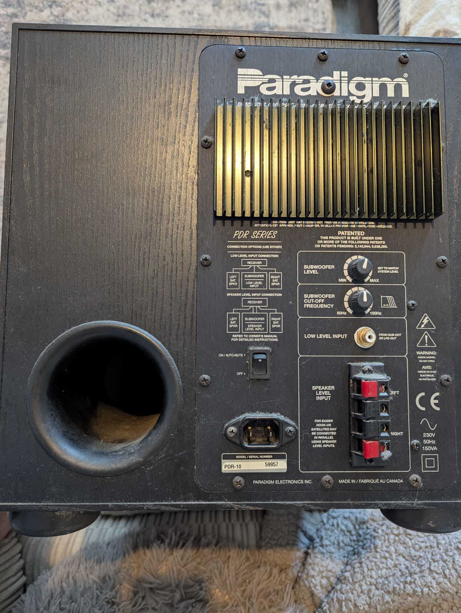

Hey all,

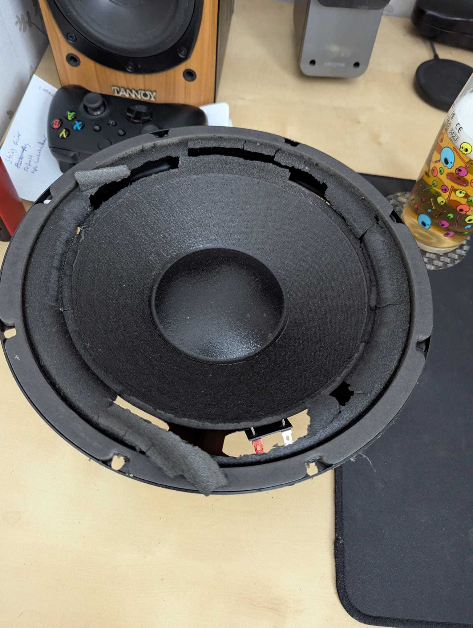

I noticed my sub had no volume other than a weak farting noise, on closer inspection through the port, the cone has seperated from the basket, so the driver is toast.
It's not had a bad innings, it's a Paradigm PDR-10, I've problaly had it 20 years to be fair so i guess the foam carrier thing just perished over time.
The thing is its a decent sub, (has a 100w mono amp built in) and the price of new active subs of the same/similar performance are.... 'how bloody much'?
So that got me thinking... can I simply source a suitable bass driver and swap the broken one out? that would be too easy!!

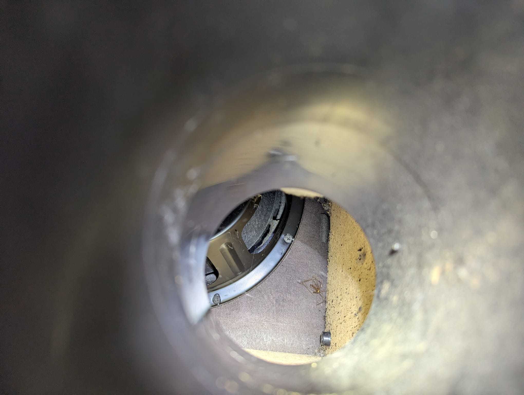

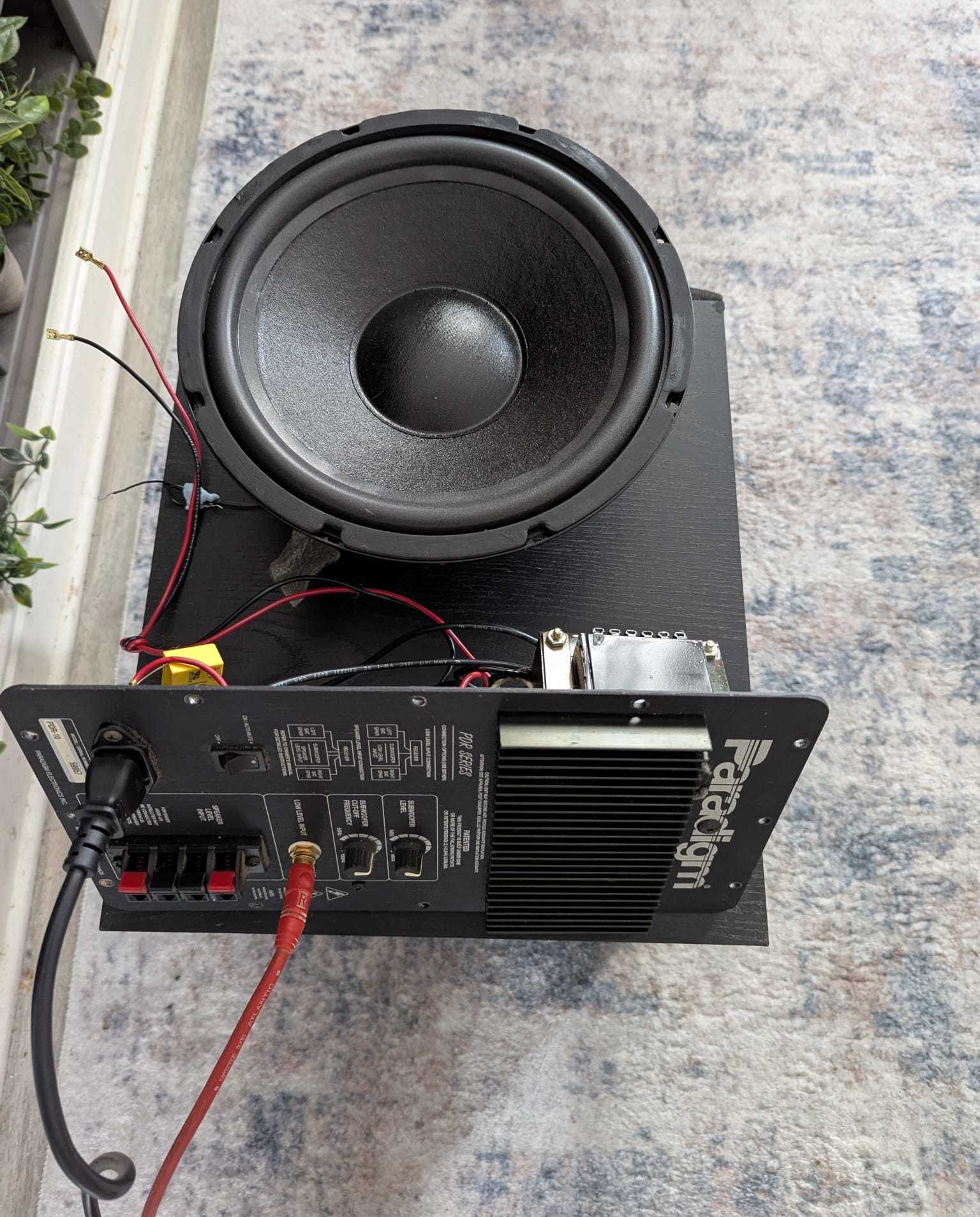

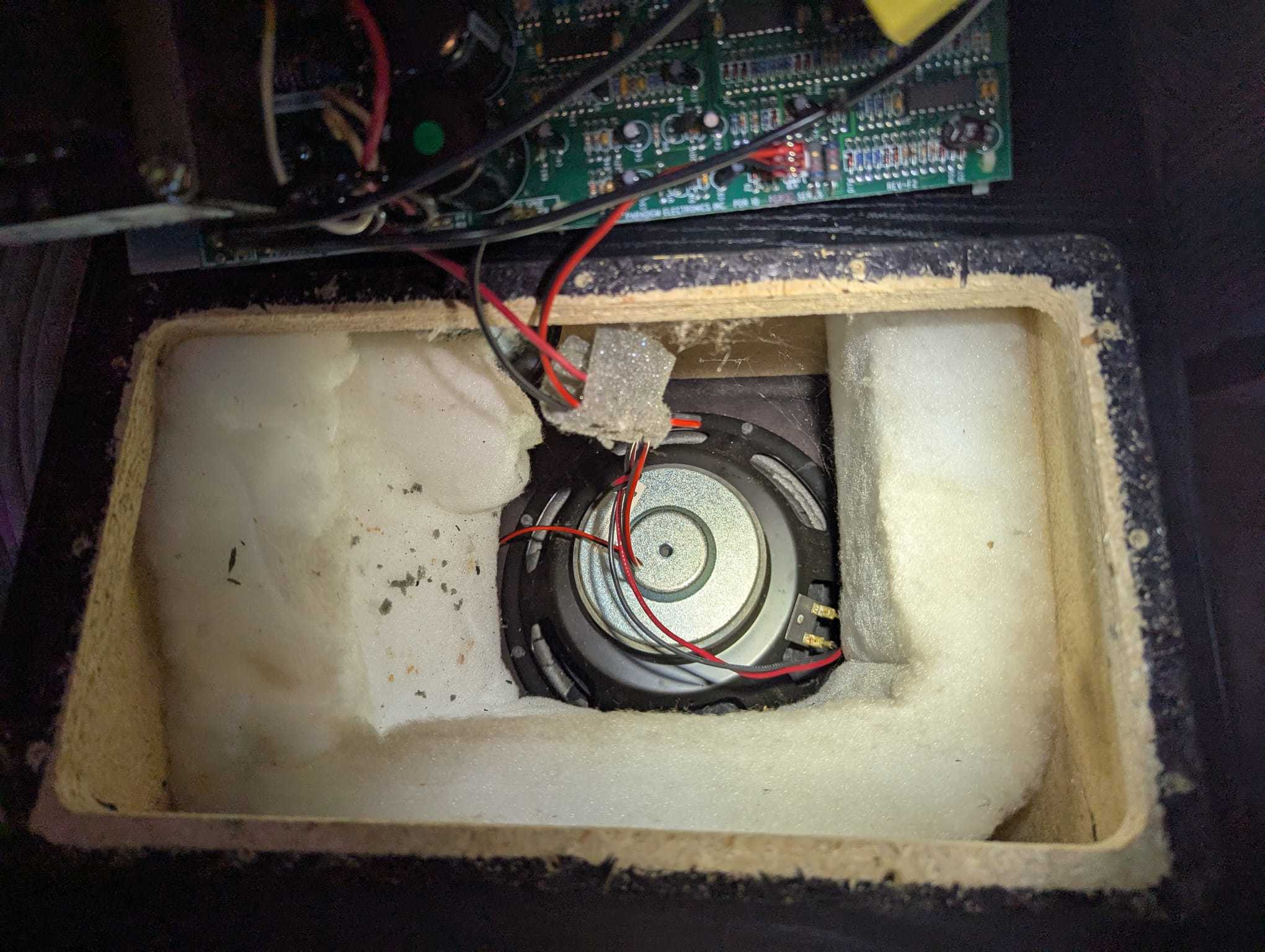

The thing is I might have to mangle the cabinate to remove it, the grille and baffle are not removable so I can't simply pull the driver out of the front, and it looks like the driver is screwed in from the rear -I don't think the hole on the back where the amp sits is gonna be big enough.
Any thoughts? the cab is just a basic rear ported design, would it be worthwhile to buy an empty cab, or build a new one copying the old one?
Thanks... yeah I dont really wanna spend 300-400 if i can just swap the driver out for a new one... after a bit more dismantling, I think I might actually be able to remove it through the hole where the amp sits...
...The hole is 11 and a half inches by 6 inches, and it's a 10" sub...
screwing a new diver in looks like it would be a challenge though to get a good tight fit..

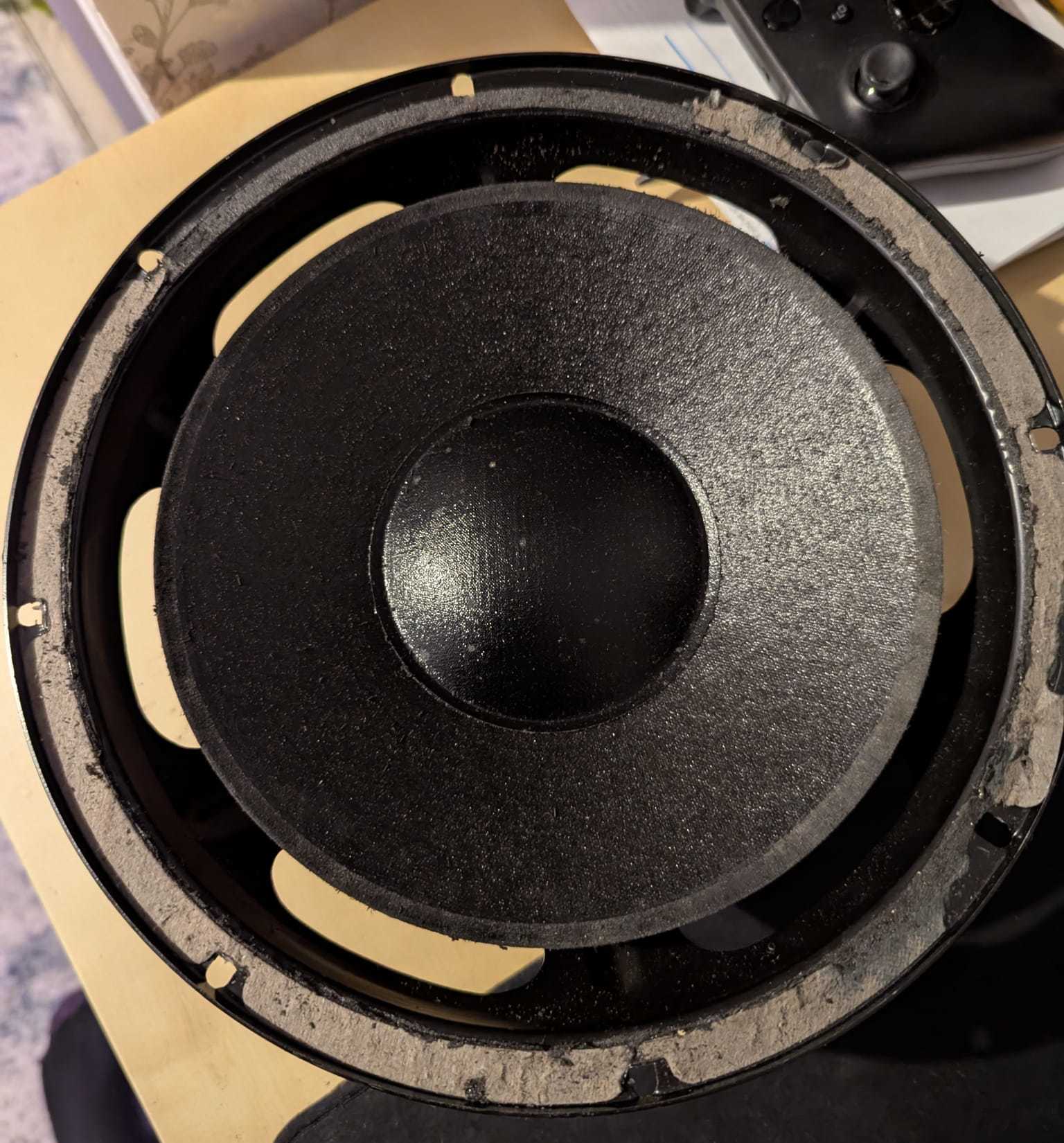

Re-foaming/re-coning speakers is a very common method to give new life to old speakers. My Dad used a re-foam kit to repair his old Realistic Optimus 400s with 12" drivers with good results.
Definitely worth a go IMO.

How hard was it driven? It could be damaged, but it could be worth repairing it anyway. About a tenner for replacement surround/glue. And even if it doesn't work, could be useful learning experience if you ever need to do it on a working driver.

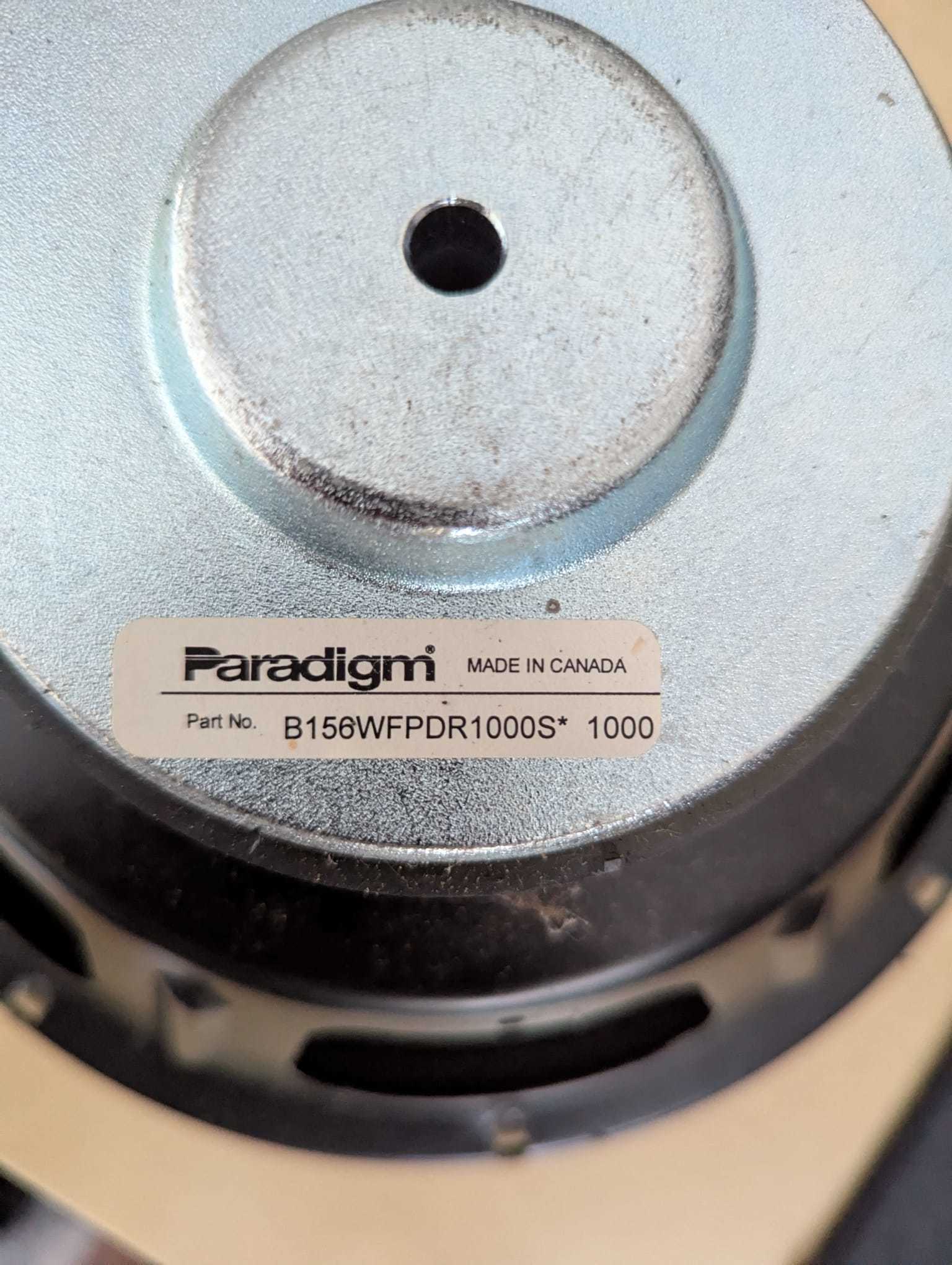

I'd replace the woofer, but then that brings it's own headache of what brand/model 10" would be a good match for the onboard amp... meh...
I've orderd the repair kit... just got an email this morning so that should be with me in a few days.

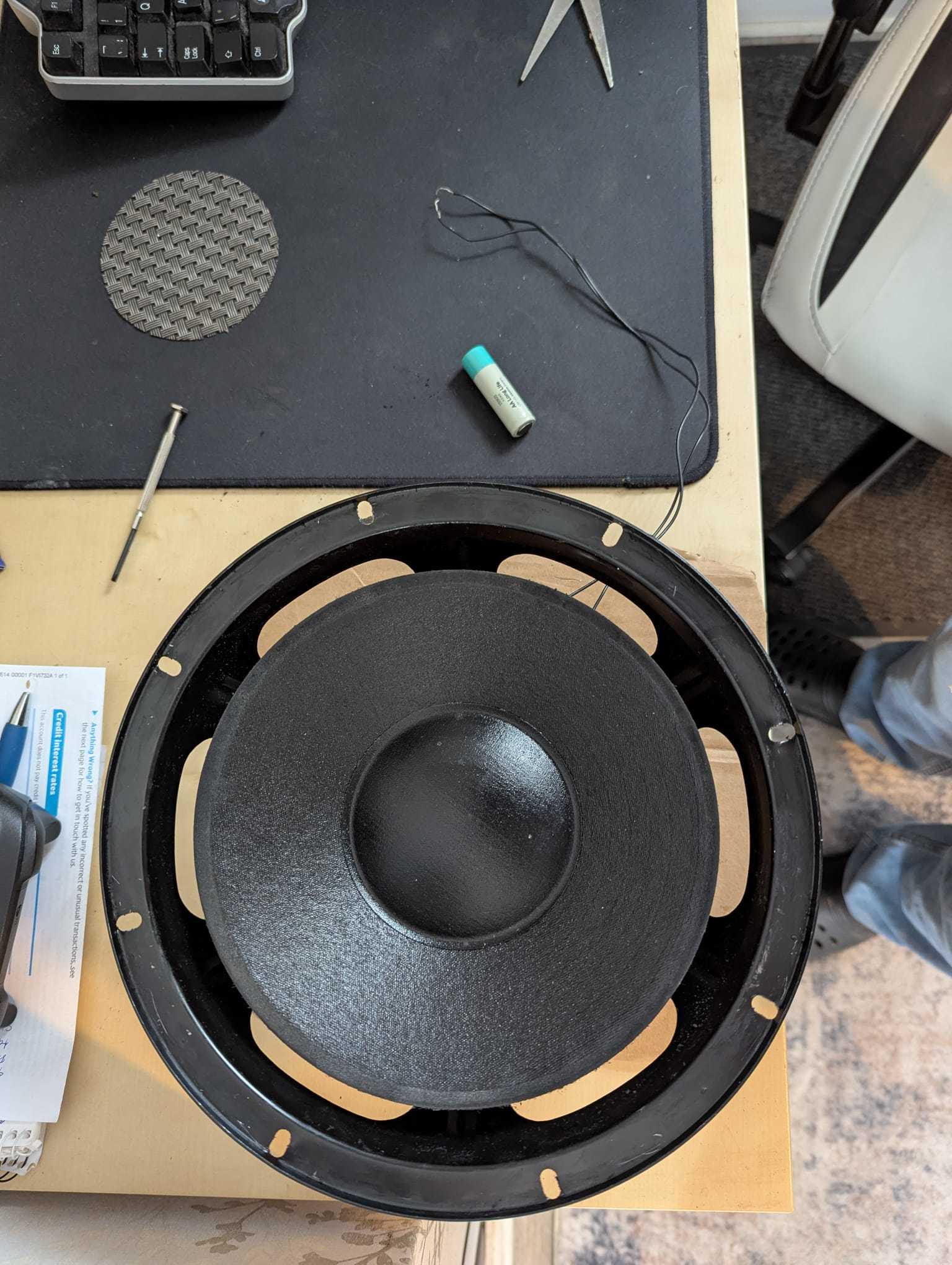

I've already started prepping the woofer, and it seems mechanically sound, bounces nicely, no scraping noise from voice coil etc, it's just the foam surround is FUBAR, so to the best of my limited knowlege, its a good candidtad for a refurb.
The amp is designed and built in house too, it's not a generic ali express mono amp - the large caps are even 'Paradigm' branded, so theres clearly some thought been put into the amp dsesign...it would be a shame to write it off if I can fix it for a tenner!

Watch some videos about reconing, you have to do certain things.
foam surrounds do have finite lifespan, modern foam has treatement which prolong the life. Modern drivers have rubber surround which should last 25+ years.
Yep already watched a few vids of people doing it.. I picked up one tip to get the surround centered with the voice coil without cutting the dust cap off and fitting shims...
Once the surround is glued to the cone and set...
... if you wire a standard 'square' 9v battery up to the speaker, the cone will go to full extension, allowing you to put the glue on the chassis, under the foam, then disconnect the battery so the cone and surround drops down perfectly straight onto the glue.

One thing I will say is the small tube of t-7000 glue is really pushing it to cover a 10"...so I'd probably invest in an extra tube (you can get a 2 pack for a fiver on Amazon).
