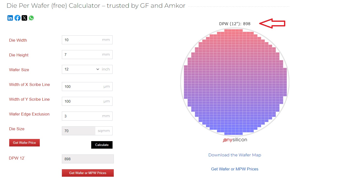

AMD (Zen4) chips have 2+ dies, IO die + CCD's. They also use different nodes, IO die (6nm 124.7 mm²). The CCD is (5nm) 70 mm2 in size, so a lot more than 67 per wafer.
Zen 5 also use IO die + CCD's, think the IO die is the same but the CCD's are different but about the same size on 4nm(think).
Assuming a wafer is 20k although I don’t believe AMD will paying that much, then for the CCD it would cost AMD around $23, it would probably be less than half that for the IOD on 6nm so I’d say around $30 for a single CCD chip and $50 for a dual CCD model.

The chips are 70mm, about 7 X 10, 9600X and 9700X have one of those while the 9900X and 9950X have two. The logic dies are $16.70 each.
They all have an IO die at 124mm, but those are on 6nm, they probably cost about $10 a pop.
