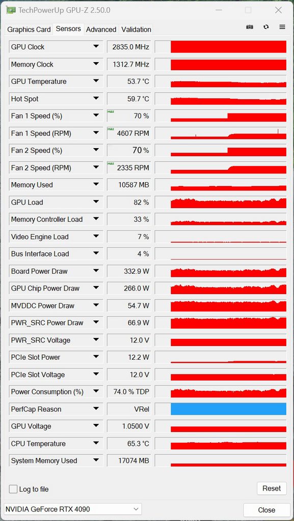

Thought it may be better to create a new post as this may get lost in the 4090 owners threads. For anyone that has a Zotac 4090 ideally the Extreme Airo version as this is what I have can you do a very simple test. Run any game and open something like GPU Z or HWINFO as this bug gets detected in all programs that can report min/max fans speeds.
Now for some reason fan 1 sensor which controls the fan near the ports and center have this extremely tiny spike in RPM reading that doubles the actual reading that happens randomly and often.
Now to start this is the card manually set at 100%, the fans max out at about 3000 RPM.
Now running any game at the stock fan settings the card will be at 30% or about 1100rpm on all fans but check out this tiny little spike on fan 1, if I check at what RPM speed is reported its double the actual reading but look at the fan speed % it never budges, and even with my ear next to the card the fans never ramp up or even attempt to, the card stays quiet. Forgot to change the average on fan 2 but it's max is 30%
Now I have manually set the fan speed to 70%, now when the spike in the graph occurs again check out the RPM, it's doubled again which for this reading it's impossible as it reads at 4600 RPM when the card can't go passed roughly 3000 RPM, but at 70% fan speed the RPM is 2300 RPM but according the the fan 1 reading during that tiny spike is doubled.
It's as it the card during those spikes is adding the two fan speeds together and reporting as double what it really is. Strange as this happens in every program that can read the GPU RPM and report the min/max but the actual fan % never changes just the RPM. Changed the number below on fan 2 to 70% as I left it on the minimum reading.
Hi, I have the same card and tried to replicate your test. I used Cyberpunk 2077 and did fan speeds 30/70/100
These are my results, within an RPM or 2 both fan speed 1 and 2 are consistent with the speed setting and I'm not seeing any doubling up.

I can report exactly the same as chrisgough, no spikes in fan speed in gpuz

Hmm interestingly I'm at 30% RPM after gaming for a while, one fan (FAN2) stayed at 1100 RPM the whole time, and the other one (Fan1) has jumped from 1100 to 2179 at a brief spike and it's done that twice. I'm assuming if I went to 100% for a period it would do the same... So does that mean mine has an issue?

It’s a strange bug as the percentage is always accurate is just the rpm, the fans are all definitively running at the same speed when it spikes. If one fan was really hitting 2400 rpm you’d definitely hear it as it would sound like a jet engine. Will try the quiet bios later and see if it still does it.
