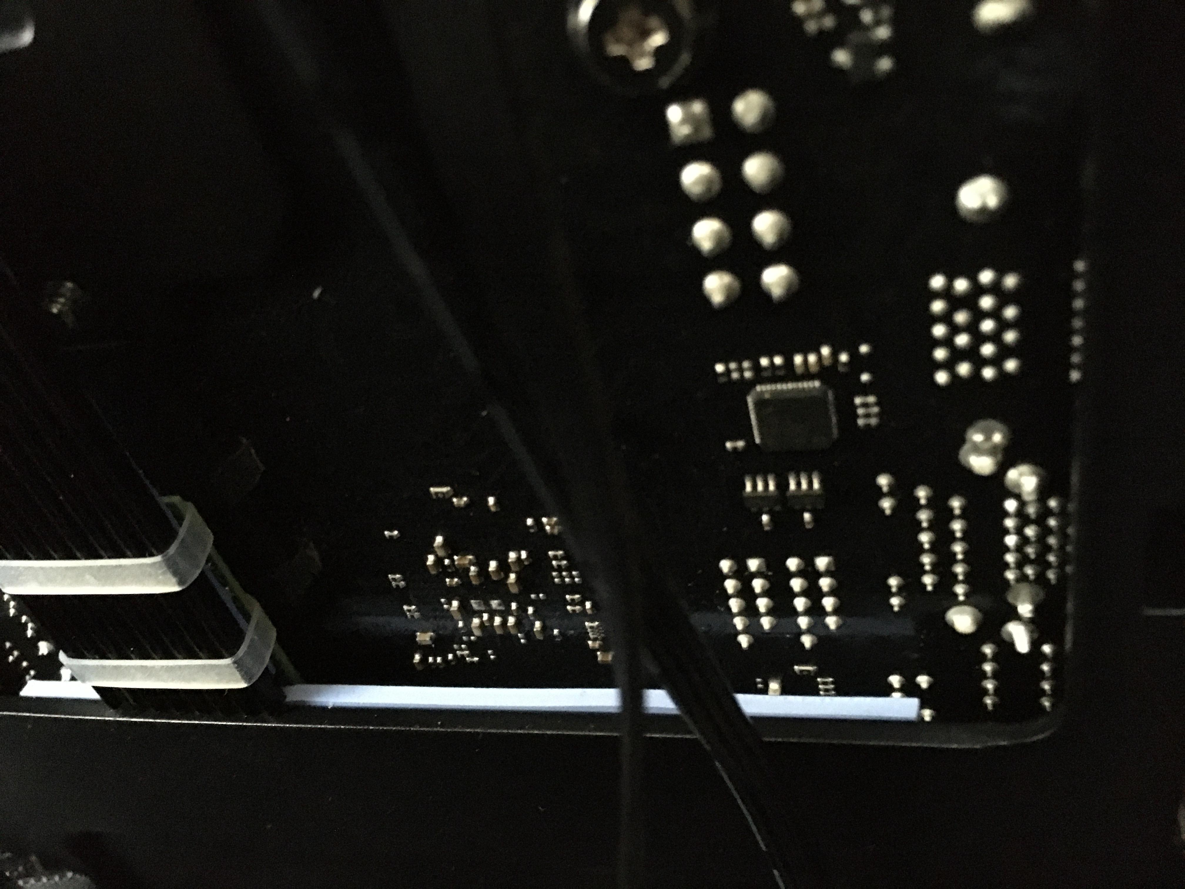

I attempted to add a water block to the chipset yesterday but the mount holes of the blocks I randomly bought previously didn't work in the small space.
I fitted a slightly thicker thermal pad on the chipset heatsink and because the M2 heatsink I had been using could only fit on part of the SSD, I added a thick thermal pad to use the case to cool the other part of the M2 SSD.
Thermal pad pic:
The SSD temp has dropped to cold metal ambient temp at idle and the max temp isn't a concern anymore. Highest temp seen under load testing was 44c but most of the time it's in the low 30s.
When I get the chance, I will add thermal pads to case cool other motherboard hot spots and hopefully it will result in slightly lower load temps and quicker recovery from load to idle temps.
