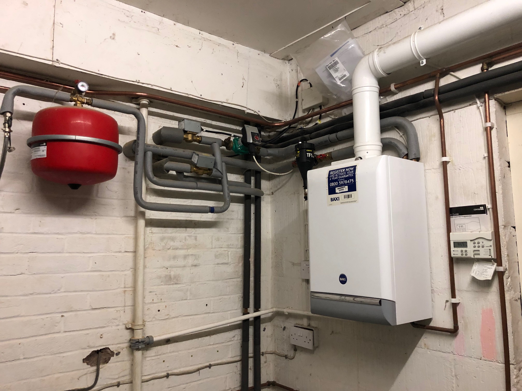

Can someone ID these boilers/systems for me

Googling both both boilers some more, this is now understood as well as the various components in the plant room (Pentair rapid sand filter, the auto chlorine/bromine feeder, the Viessmann combi, etc). I clearly need to find the storage vessel(s) for the other Baxi heat only boiler. Worth posting this thread for me, the knowledge here is great sometimes. :)
