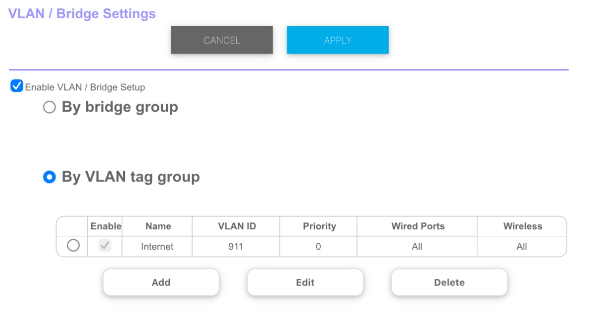

You just need to be able to set a VLAN tag of 911 for City Fibre which you should be able to do on your Netgear
Is this for any City Fibre provider? Is it something that you do regardless of whether the provider needs credentials entered or uses DHCP?
Yeah any provider, most routers allow you to do it.
Aquiss has guides for the main router brands.
https://support.aquiss.net/en/knowledgebase/category/vlan-id-setup-guides
While not normally required, if your router doesn't support VLAN ID, or you for example used a virtualised environment, it's possible to pre-tag the incoming interface with a VLAN ID using a managed switch or something like Proxmox, you then just feed the router or virtual router a clean DHCP WAN connection. I found this approach quicker and easier when messing about with multiple different routers/virtualised routers.
You’re either using a preconfigured router supplied by the ISP or the Lit Fibre built network doesn’t require a VLAN tag, City Fibres network definitely does.

You are on CityFibre's network if you got an email a couple of months ago about maintenance work and your IP address changed. If you move to a different ISP then CityFibre come and swap your ONT. Not every ISP on CityFibre uses a VLAN, I'm not completely sure of the reason behind it because it's a bit awkward but any decent router supports it. At a guess it's to stop people plugging the ONT into a switch, having one device get a public IP address while none others work, and generating support calls.
