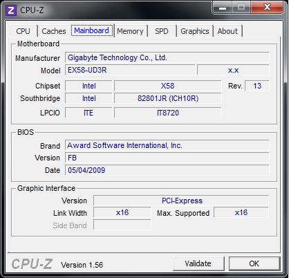

Why don’t you download and run CPU-Z it will confirm board/bois versions.
Positive, in the corner of the board it says Revision 1.6
Regardless I've ran CPU-Z and here's the results.
