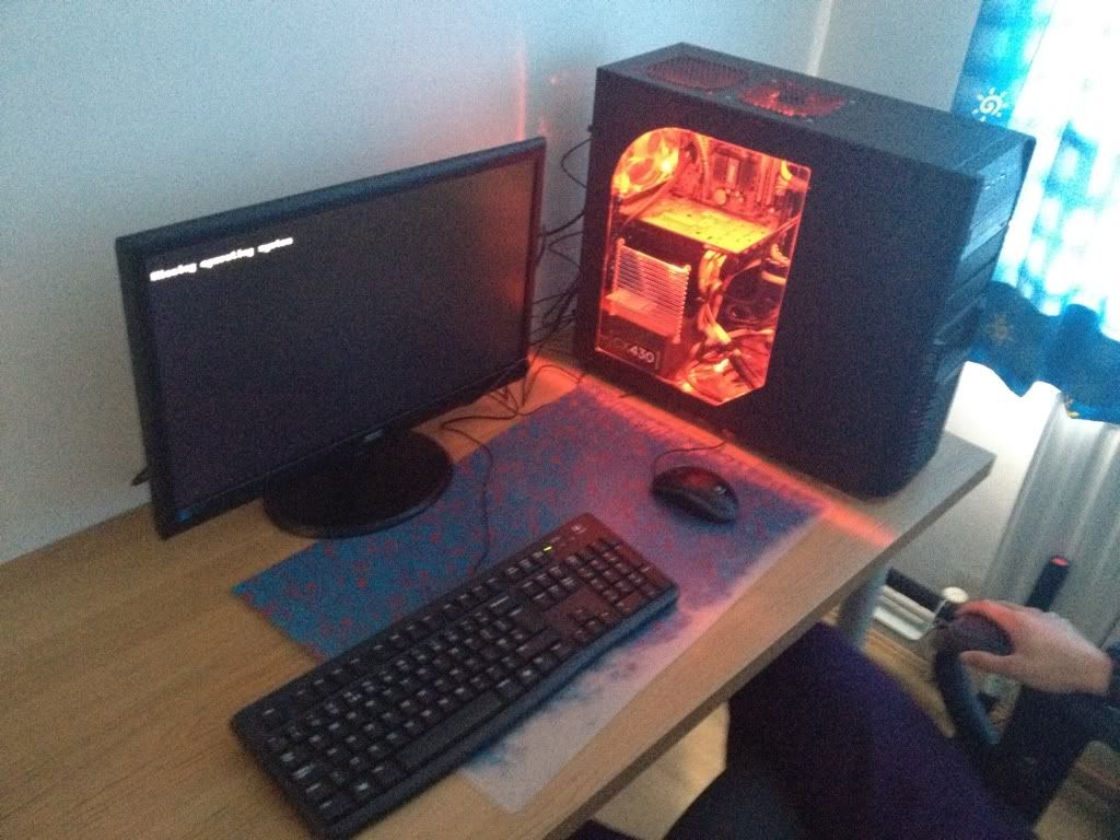

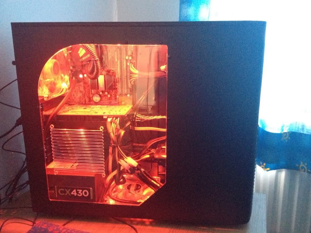

Would have done more with cable management, but the case has virtually no options for cable management at all and the PSU cables weren't long enough to take round the back. If I had to change anything, it'd certainly be some extensions for the 6 pin cables as they look terrible but this build was done as cheaply as possible so we didn't have as much money to play around with things that were "unnecessary" as I am otherwise used to.
Overall though, my friends more than happy with it and infact loves the "messy" look, I think it's mainly the red he's transfixed by xD
ANY COMMENTS/CONSTRUCTIVE CRITICISM WELCOME :)
