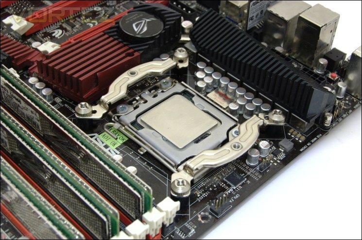

Hi I am trying to install this cooler on to my board but when I have installed it the cooler is facing the graphics card and not the ram?? Yet in all the I turns I see of everyone else's Rigs it is facing the ram. If I try and face it towards the graphics card it fits perfect but towards the ram it doesn't fit at all, have I messed up something with the backplate? Really baffled as followed the instructions perfectly.
Sounds like you installed the bracket 90° the wrong way :) Unscrew it and fit it so that the two mounting plates/arms are at the top and the bottom.
Hope that makes sense.
EDIT: Like this:
