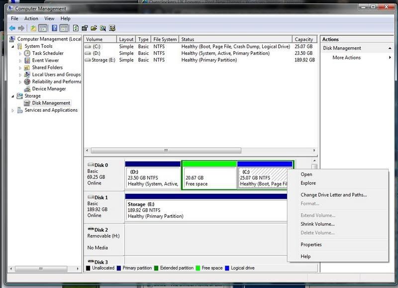

Back into vista.. disk management, extend partition.. no space available?? It's showing 30gb spare space but if I use extend partition I get nothing, no option to extend disk??
Just this

vista can't work with free space before a partition - it has to be after it. :p
and the layout you have there is a mess what with logical and extended drives. the real way to sort it would be to wipe the disk clean and start again with primary partitions only. but i'm guessing you don't want to intsall xp and vista again? :o
