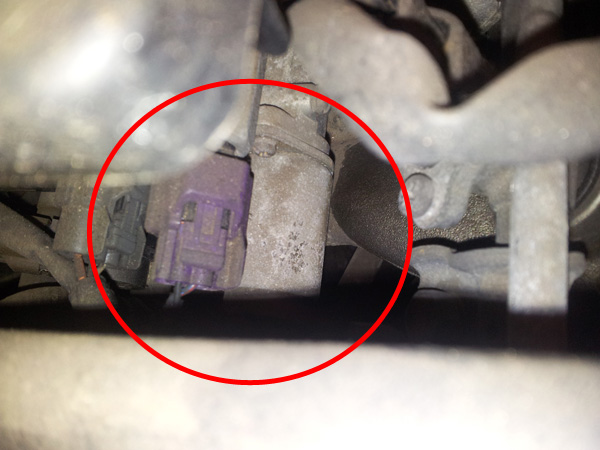

Do I have a case in pushing for the repair of the sensors, as this is what the AA Patrol found? I couldn't find the "Auxiliary Air Sensor" on eBay. Could it be an idle control valve which I am looking for?

I assumed your air sensor was probably just a part of the map/maf sensor the car had but tbh from that (limited) picture it doesn't appear to be. I don't see that an icv would cause you much in the way of running issues other than at idle/ low revs but if that's what the sensor is attached too you could take it out and make sure it moves freely/clean it up.

The sensor is under the air box, not where a MAF would usually be. This car doesn't seem to have a MAF, as I have always known these to be in the intake hose before the filter?
I have no way of checking that then, as I don't have any kind of area I can do a smoke test. I only have a driveway, no garage. I can do most things on a car (I could change all the sensors myself, but don't want to waste money on it).
Closest thing I can find is an Air temperature sensor which should be in the bottom of your airbox, I take it this sensor is actually located in the box and not underneath it?
Again it's clutching at straws without any sort of actual diagnosis but it could be a start. Looks a very cheap part too.
Nope, looks totally different to the sensor which is currently unplugged. I am just heading off to work now. I will get a picture in the morning of the location of the part!

That's where the sensor is. It's the "Iacv-aac valve" which is disconnected, I am sure of it!
e: Went on eBay - £49.99. It is the one which is disconnected, so I guess I should phone The AA tomorrow to get it in to a dealer or at least someone who can test it.
