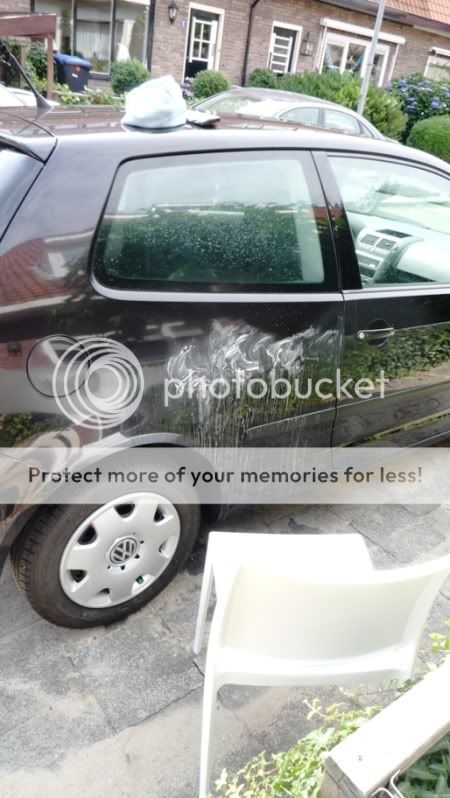

@ OP,
There is some hope of making it even less visible without respraying with a touch up kit, wetsanding and polishing.

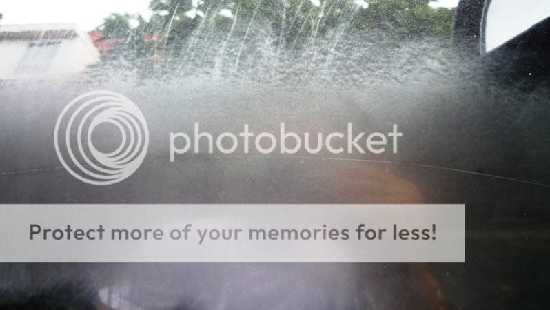

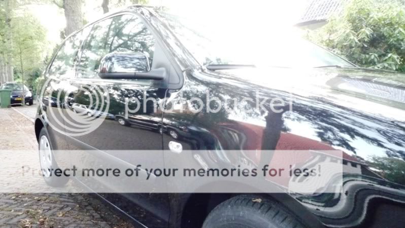

One guy managed this on his Polo:
First:

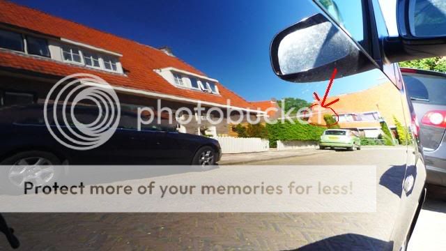

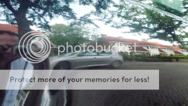

The scratch length:

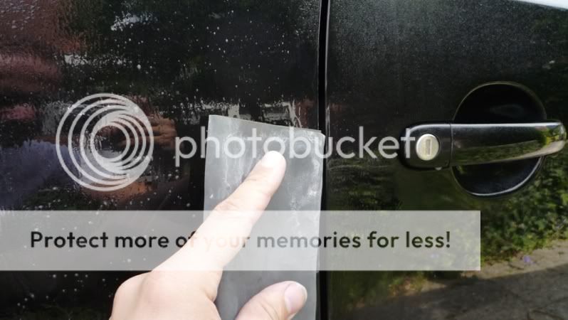

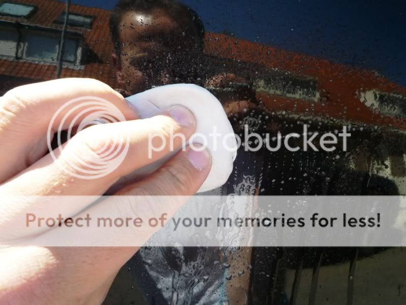

Claying:

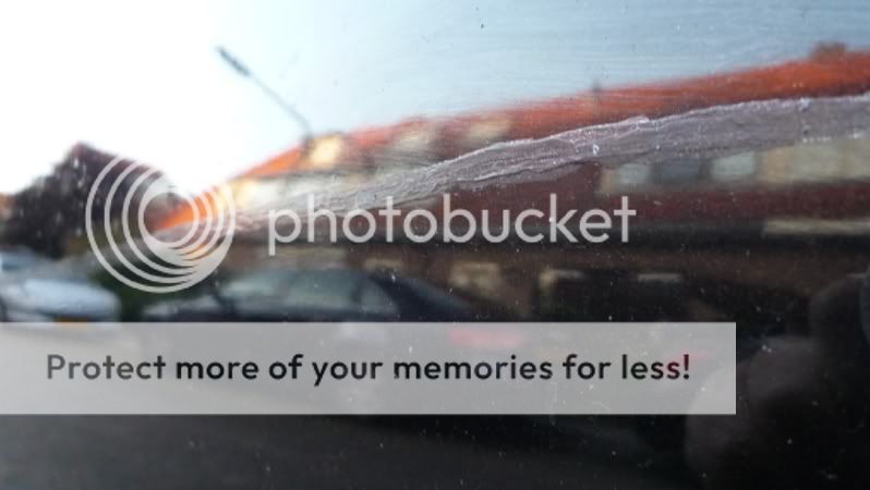

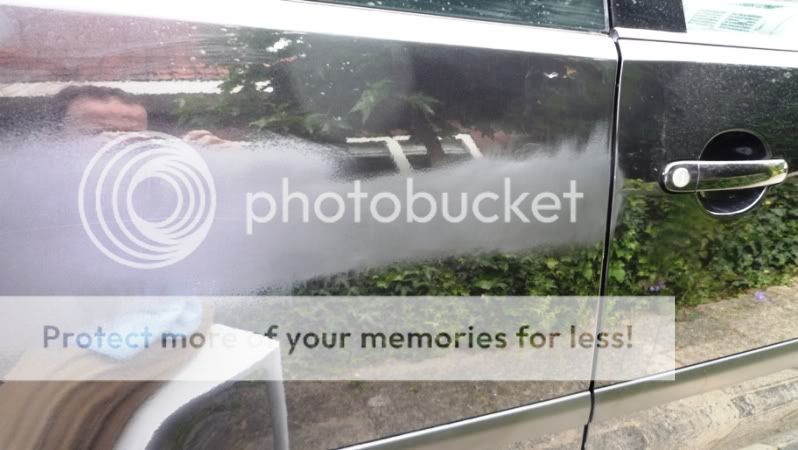

Filling it up with a touch up stick ( once per 3 days a new small layer, for a couple of weeks):

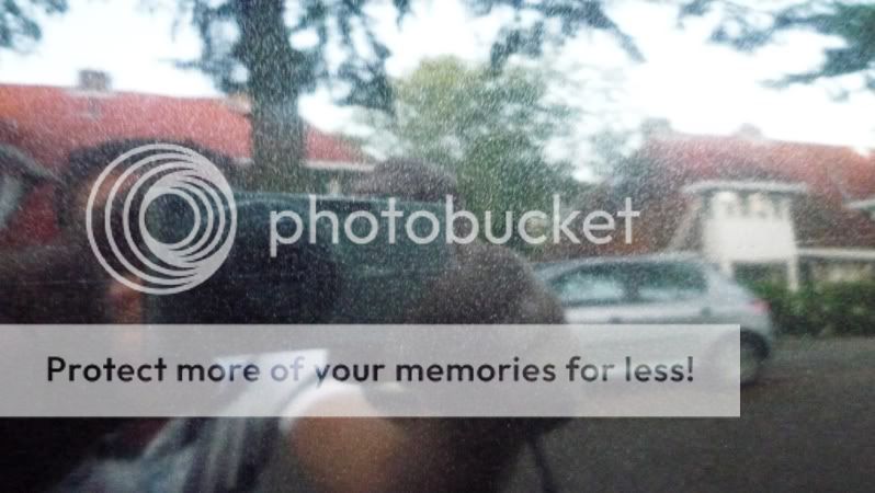

Wetsanding with patience:

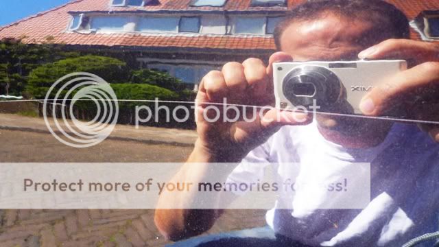

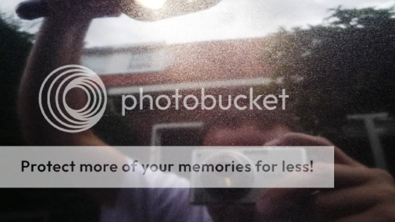

Finally Polishing

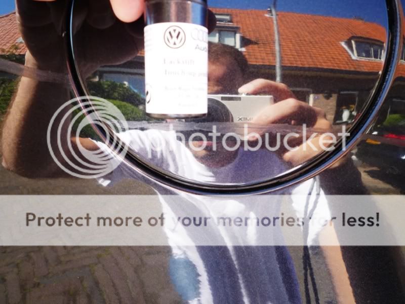

Result:
If you have the time, patience and don't think it's worth respraying it's worth a shot.
Or if you have the stuff, and ARE planning to respray it, it's also worth a shot, if you mess up then no harm done since it was going to get resprayed anyhow.

But it cost a couple of tenners ( provided you have the pads&rotary already)... As you can see from anywhere but from inches it's not really visible. A respray of one third of the car is significantly more.
Do people want to spend a couple of hundreds or a couple of tenners, if they don't sit at looking 20 inches away looking at the bodywork? I doubt Joe Average would notice there was a scratch there if he saw the car, unlike before.
Besides, even if you ARE planning to respray it, why not give it a go with a touch up stick and wetsanding yourself first if you have the time, if you mess up or are unhappy you can still go to to the sprayer.
We're walking about saving 8x the money here or more.
Of course if you're a busy person earning enough not to worry about a couple of hundred for respraying 1/3rd of the car or 1k + for a full respray... But if you have loads of time and little money on your hands...
You have to admit it looks many times better in the last pic than in the first couple of pics, even on such a small image (2nd pic) from so far you can see the scratch slightly under the red line. On the last pic you can't see it from FAR closer.
The guy already had all detailing things like a rotary&pads, 2000grit and 1500 sanding paper, and polish. He only bought a touch up stick, a claybar and lubricant, a couple of tenners for that result, it's an amazing result imo.
All that effort is to not spend xxx or xxxx quid but xx quid to an acceptable result instead.

It's metallic black, there was NO POINT in touching it up just to sand it off again!
Why didn't he just sand it then polish it up?
Or just flatten the laqeur with G3.
Looking at the pics it's hard to say but he probably could have got a better finish still without going through the laqeur.
The post says he used the touch up stick to fill the scratch before sanding it, I assume this didn't work that well because the new paint sanded off far more easily than the existing paint. I don't know however. All I know is that the result is very nice imo from the scratch he started with and quoted most of the pics.
You wouldn't want to fill the top layer of laqeur with black paint - because that would be like me covering a patch of gloss on my wall with undercoat!
Guy is a n00b and should stick to detailing the exhaust pipe on his 1.0L Polo y0.
He hasn't done a bad job, but my guys could have done that in an hour max not 3 weeks or whatever it took him!

His intention wasn't putting any paint on the clearcoat and fill the scratch, obviously with the standard brush that's impossible, better to have normal paint in there than primer or even bare metal showing ain't it ? But that is harder than it sounds I'd assume.
He said he did the filling in 6 layers 15 minutes of work each spread over a couple of weeks.
Then 3 hours sanding & polishing it.
With the last 3 pictures barely showing the scratch ( only 1 of the 3 pics actually shows it), I find it hard to believe you can wetsand and polish a whole line on the side of a car in an hour.
What don't you understand? There was no point putting any paint in the scratch because the scratch had not penetrated the laqeur, all he's done is polished away the laqeur to make the scratch less visible which he could have done just using cutting compound.
So there was no primer showing or any bare metal showing, it hadn't even penetrated to the point of past the top layer of laqeur because that finish would have been unachievable if it had.
You may find it hard to believe but then I suppose you don't have to deal with this on a weekly basis.
He says it WAS down to the base coat/primer. The finish is achievable BECAUSE he filled it with a touch up stick.
http://translate.google.nl/translat...epe-en-lange-kras-wegwerken-auto-gekeyed.aspx
Read it yourself if you want, yeah it's not his car I see now but it's quite clearly through the laquer. I don't see anyone else questioning his method even though it's a detailing forum or making claims it's only in the clearcoat...
Can't believe I'm defending a guy I don't know but your claim from a couple of pictures that it's not through the clearcoat is ridiculous.
