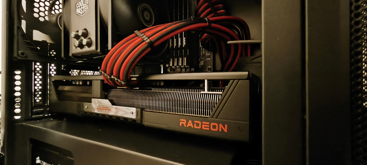

just as an example, this is my pc, i'm using combo 3+5 with 2x 140mm slim fans at the bottom and an AIO up top for the bottom-to-top airflow pattern
the cpu (7800x3d) and gpu (4080 super) runs very cool and quiet even under full load
if i had combo 3+4 i could use full thickness fans but realistically the airflow with the slim fans are good enough i doubt the temperature differential would be noticeably significant enough
so, tl;dr, if you go combo 2+4 you could also do the same and mount slim fans at the bottom to enhance airflow

I've just squeezed the Pulse 9070xt into my Kolink Citadel Mesh but the card is only millimeters off the bottom. It just fits.
I'm looking at the Phantek XT M3 for a little more room and the addition of fans on the bottom for better cooling.
@neocon So what case did you end up going for?
