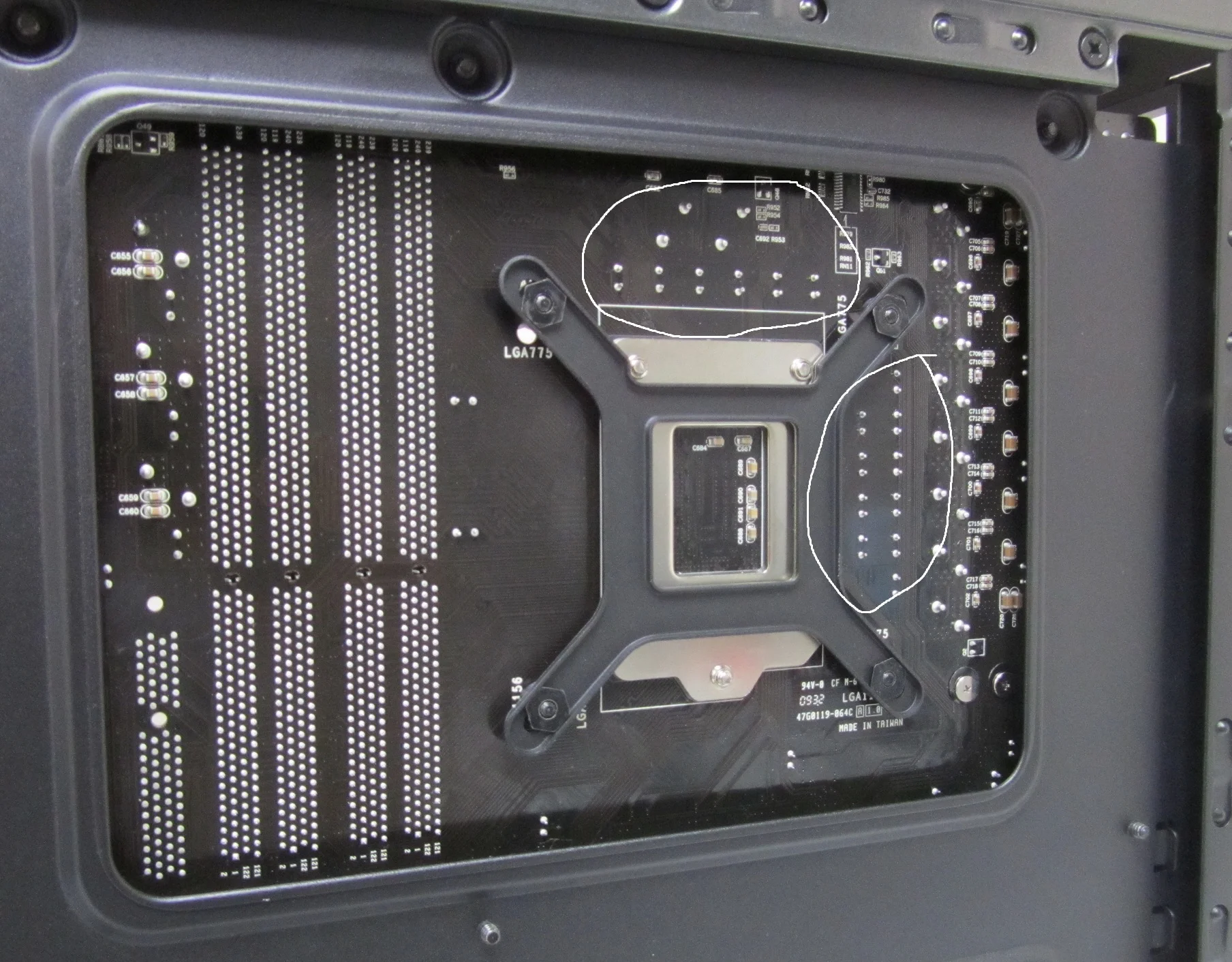

Ok thanks. This is the bit I mean...

If you're building the PC for the first time then you assemble everything with the motherboard sitting flat on the bench, desk etc. That hole in the mounting plate in the picture is for swapping cpu's in situ i.e. if you're swapping one for another on an already built PC so you don't have to take the entire motherboard out just to swap a cpu. Thats an innovation times gone past that hole didn't exist and remove the entire motherboard was the only option which is a major faff un-and-reconnecting all the cables, pins etc.
