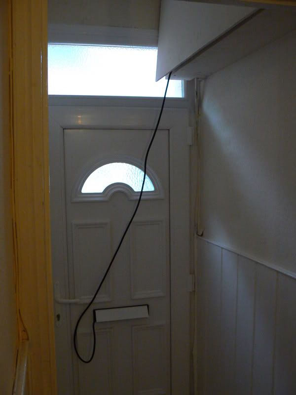

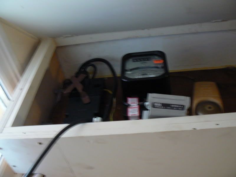

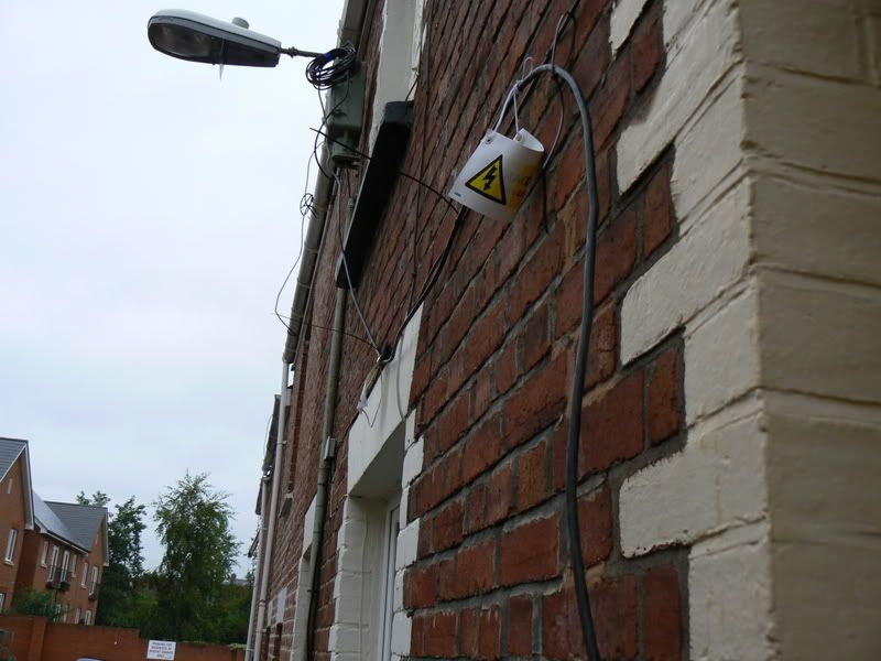

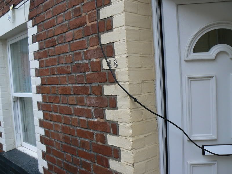

lol aint mine, guys electrics gone off in his house but rest of street are fine.
"electrician" wired him up until they can get power back on.
Dont suppose he asked for company id card beforehand :D

I assume yvou mean a cable jointer from the local DNO? not an electrician?
It does indeed look RAF (rough as....), but does seem to be an offical DNO bodge

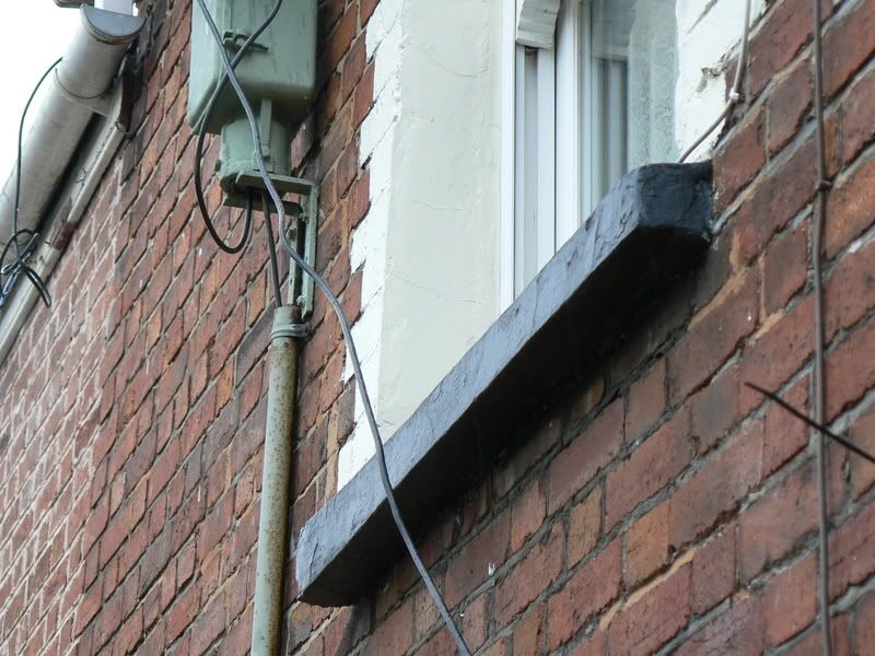

Well just to put you in the picture contractors working for british gas are responsible for that cowboy job ;)
I'd expect they are contractors for your DNO (which depends on the area you live in: http://wiki.diynot.com/electrics:other:dnomap )
Its all been privatised now you see ;) , you pay your bill to the electricity supplier, for electricity which flows down infrastructure looked after by the DNO, and its measured by a meter looked after by a metering company
And I'd bet money on it being straight-con ( http://i69.photobucket.com/albums/i62/RFLighting/StraightCon.jpg ) and not armoured, the former is quite a bit thinner than the latter for the same CSA (cross-sectional area) of conductor, I'd probably guess that to be 16mm² straight con

there is no way the armoured in the picture is 16mm it's too small to be 16mm 2 core aswell. to me it looks like maybe a 3 core 4mm or smaller. i doubt they would use the swa as the earth.

looks like 35mm PME to me. it only has one core

In the case of Concentric (think of it as a giant sized version modeled on the same idea as tv coax) the inner conductor is phase, while the outer one is either neutral or CNE (if the supply is PME)
