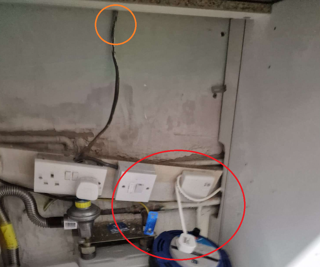

Woke up at 7am, with the electrics all off, trip switch kept going off instantly when I turned it back on.
ID'd it was the ring-main for all sockets. Unplugged every plugged in socket, and still doing it. Ended up getitng an emergency sparky out on Easter day.
3 hours of investigating he found the issue, a mains cable routing into the wall behind a kitchen cupboard was rubbing on the bottom side of our marble worktop, and marble is harder than the plastic coating of 240volt mains wire, so after some years it finally exposed the bare wire and was shorting the whole system causing the trip.
Now he is coming back Tuesday to fix it properly, but short term he isolated that cable for me and made the rest of the house all safe and finally have power at tea time.
He needs to channel the wall and put in new cabling and ensure it is all contained so this cannot happen again.
I'M NOT SAYING IT IS MY FAULT, BUT I DID INSTALL MY KITCHEN MYSELF 4 YEARS AGO. So who knows, right?
so tell us how he located it then ... can you triage based on resistance to ground stepping round the various exposed sockets/boxes on the ring
He advised that even though from the RCD box there is only 1 ring main, the actual main split into 3 outlying main loops.
He isolated 2 at a time and work out which loop was the issue. The problem then was identifying what sockets were on what loops. He worked on each socket in the house, but unknowingly (to me) some sockets were run as extensions from other sockets under floorboards etc, instead of being done seperately from the major ring loop, this caused some more time to ID what exactly was going on with various sockets.
He finally got it down to a loop which runs one side of the kitchen - took a little longer as the other side of the kitchen is one of the other 2 loops. Anyway he run some resistance tests and found the offending area, and then he had to investigate, pulling off the socket covers and test each metal back box and all connections. He finally got down to the final section and after revmong the rear of the cupbord from the wall, which wasn't the easiest job due to big old marble polished worktops that I installed in the kitchen, luckily the cupboard in question I fitted a "fake" rear back to the cupboard which I made removable as the gas meter is located in the rear of this cupboard.
This is the offending cable and "dodgy" wooden plate which was how the socket etc was previously installed before I ripped out the kitchen and reinstalled new cupboards etc.
Note in the orange circle, that is where the cable has rubbed and exposed the bare live wire causing the short.
The red circle is the boiler power which normally goes from the middle fuse box into the right box for the boiler. He temp made cut it so its connted to the 3 pinplug until Tuesday when he can come back and fix the bodge job that was in place for a long time. This is how the electrics were setup when i installed a new kitchen, but the worrying thing is that got signed as safe by an electrician who upgraded me to smart meters maybe 1 year after the kitchen was updated by me.

Dear god please lift the electrics away from the Gas meter 150mm minimum distance for anything switched.

Nice guy too, he explained everything he tried and found too, he did show me that my 2 socket plug behind my fridge/freezer was unearthed and could potentially cause the appliance to become live if a leak occurs, he is going to also fix that for me on Tuesday too.

Err not sure that’s code lol.
Isolator needs to be easily accessible, the use if extensions in a ring, and bettern not have a small gas leak..

I’m no expert but that all looks pretty dodgy to me. If my electrics were tripping and I had that in my home, I’m pretty sure it would be my starting point
I may be wrong but I'm guessing from top right that the panel used to be the support at back of cupboard and has been broken away to find issue?
