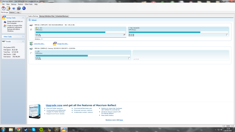

I have just used Macrium Reflect to clone the HDD to a new SSD.
My C drive is a 120GB partition on my HDD with 97GB on it.
My new SSD is samsung 850 EVo 240GB.
After cloning the C partition I now have a 120GB partition on the SSD with only 64GB data on it.
What have I done wrong ?
I didn't want a partition on the SSD and where is the rest of the data ?
Its macrium reflect,it doesn't expand to fill the whole drive,just go in disk manager click on the ssd and expand the current partition to fill the space of the ssd
Its in the guide I posted
Idk it should be an exact copy
Could always clone again,also how much ram you have? Pagefile will reserve same amount in ssd space but that still won't explain the missing data
I've not used Macrium, but it could be excluding the page file, hibernate file and any shadow copies (system restore etc) from the backup to the other disk.
