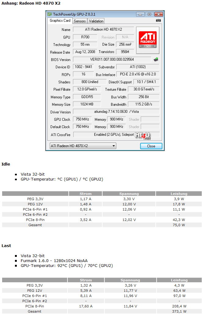

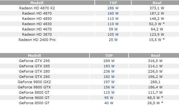

Have a read here. post #4.
Cheers for that, very handy chart, didn't come up on my search.:)
Looking at it, ATI have clearly made inroads into power consumption. I didn't think a 4870 would be suitable but stand very much corrected.:)

Fantastic link, the power consumption charts on that site are very interesting.

Each 1950XTX is drawing nearly 125W under full load, so 250W in Crossfire at full speed. They are pre-overclocked GDDR4 specimens too.
No worries fitting a 4870 or indeed a 4870 x2 if it fits.
