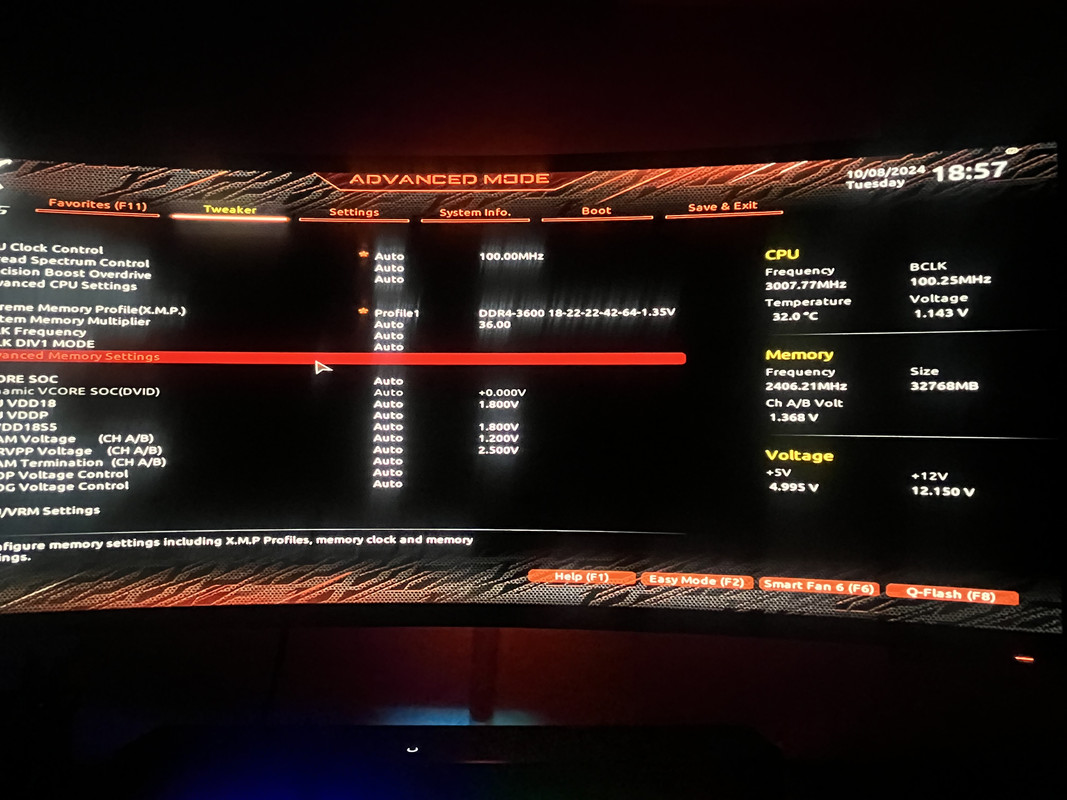

Hi there, I got the ram and set it up but for some reason it's not going above 2406mhz
I have the exact same result with XMP on or off. Any suggestions?

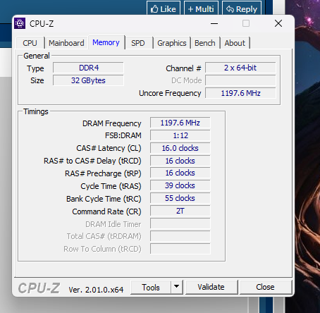

Is the DRAM voltage not being set? It looks like 1.2v in your screenshot (the end is cut off).
What happens when you restart? Does it fail to POST and reset?
Those timings could be tightened up I imagine with that set, although the X3D chips don't notice that sort of things all that much if you can't be faffed.

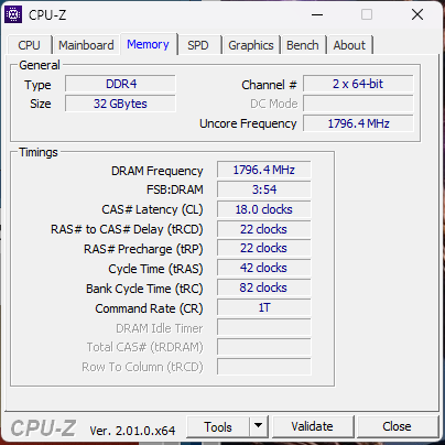

i have my sticks set to XMP and running 4000mhz, i kep saying im going to mess with timings but x3d really doesn't care
