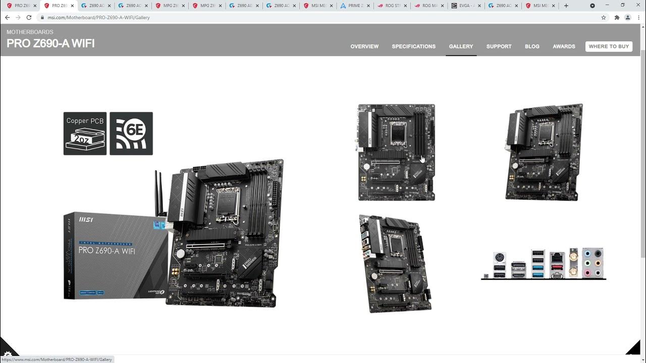

Watch this video
I prefer the 2 DIMM slot motherboards because DDR5 can easily reach 128gigs with 2 modules and it improves overclocking but that does reduce capacity overall.
Happy to say the MSI Z690-A is one I'd go for considering the price to performance.
Here's a round up too
