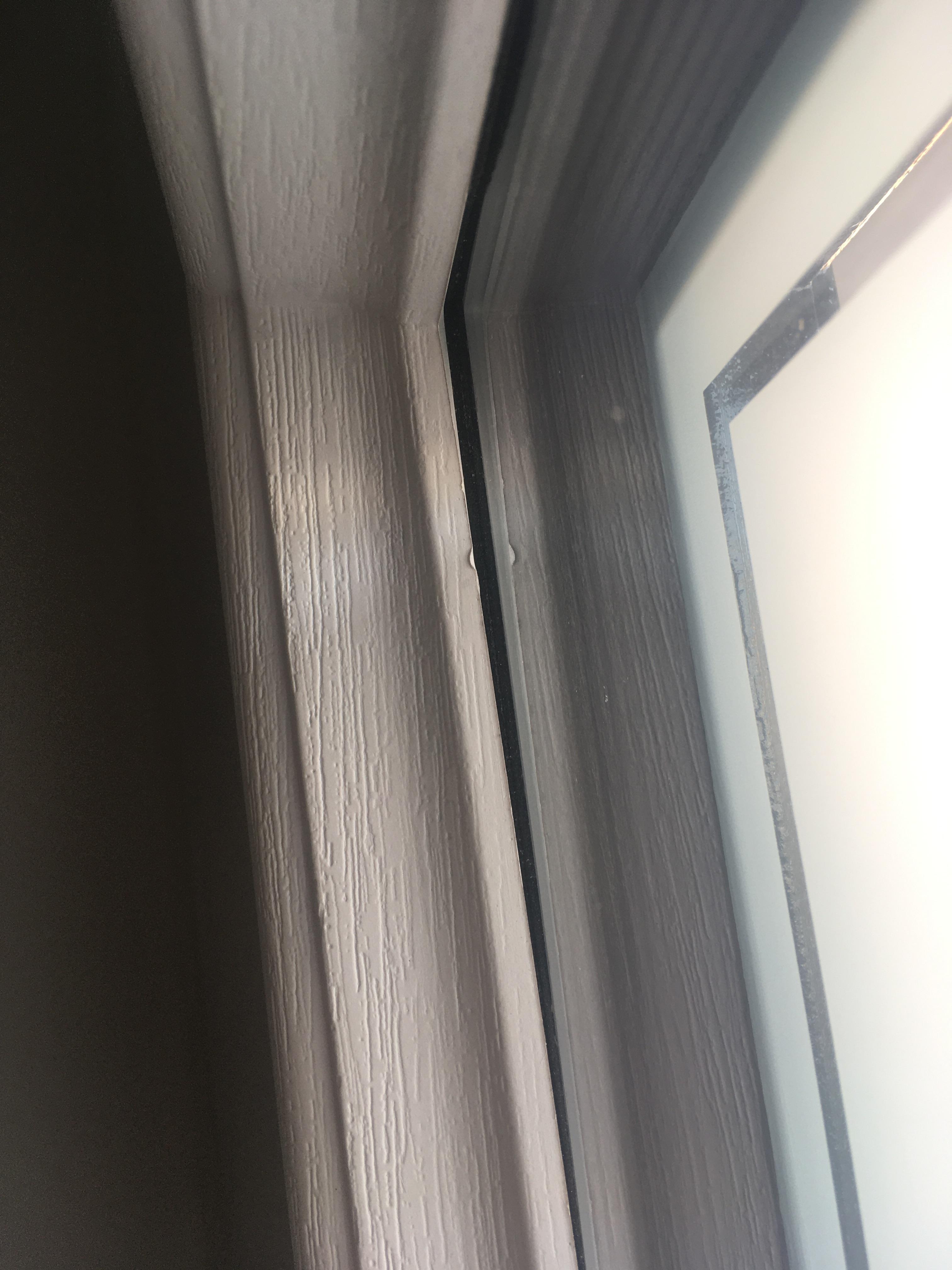

The first front door arrived with incorrect glazing. This was replaced by the fitter, and the door later replaced due to the bowing. Sadly Endurance had fitted the wrong glazing again, so the fitter had to swap it over and the trim doesn't fit flush with the door now. And still lots of draughts due to not making contact with the frame seal. The weather brush strips further inside are cheap and don't go all the way round, big gaps where the hinges are. Had to add some brush tape to block out the major draughts and socks as a draught excluder at the bottom.

The rear door also has issues with the glazing trim not being flush and sticking out at the corners, came like that from the factory and waiting on the fitter to come back and say whether it's a manufacturing fault. He did quickly look whilst changing the bowed front but I imagine thought better of it taking the 9 panes out, would probably never get them back in.

Yeah the fitter didn't adjust the door properly given it's not making a seal on the frame. They're back at some point in the next couple of weeks, I don't hold out much hope >.<
The glazing was Endurances fault, as is the trim issue around the glazing, which is compounded by the fitter fluffing up having to refit the correct glazing. Not sure I want the fitter trying to fix the rear door trim as it's 9 panes, it'll be one of those jobs it doesn't go back together again haha.
Edit: rear door is fine at the moment, no draughts. There were after first install and they adjusted the alignment.
