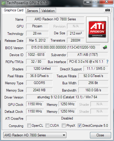

I raised the core by 25Mhz from stock with & without voltage increase and i still crash and yeh gpuz does register a voltage increase.
GPU-Z screen shot http://gpuz.techpowerup.com/13/05/06/br9.png
It's a good speed already. The volts are a tad high but not surprising with a factory oc. As above some silicon just can't hit higher clocks.
The only last consideration is temperature. Both the core itself and the vrm's. Not sure on your make/model's monitoring capabilities but the sensor tab on gpuz will show core temp and possibly any vrm temp readouts. High temps on either will affect overclock ability. In my experience and from what I have picked up reading about keeping both sub 70 deg celsius is ideal for pushing higher clocks.
OC load temp is high enough that it could be an issue, hard to say. but still need vrm temps, they could be 100+ for all we know :p
Short of spending £ on cooling for little real world gain, due to the diminshing returns alongside ramped up temps and volts as you go higher than your current clocks, you wont know for definite.
1200 core is a typical averge oc limit for hd7xxx, you just don't hear of them as often as the 1250-1300 ones, so you are not missing out on much tbh.
