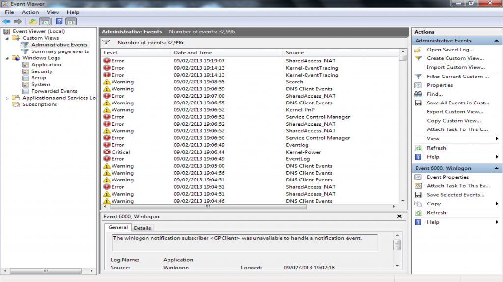

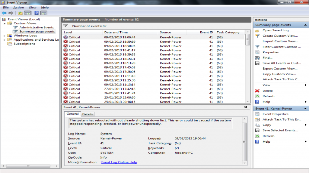

forget that i turned off the computer and took out powercable, put in hard drive and now it is switching off when i start into a game.
No BSOD crashes just turns off then turns on...
