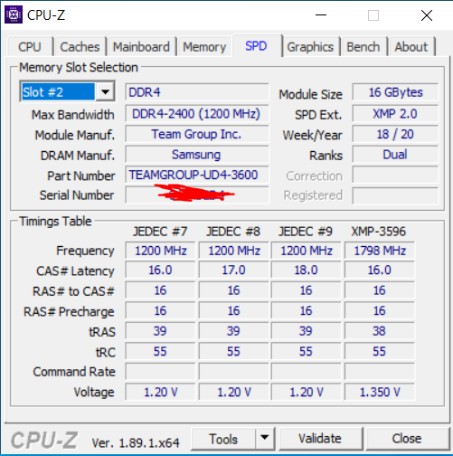

May sound like a stupid question but how can you tell if ram is single or dual rank? I have Cosair Vengeance Pro RGB but not sure if its single or dual rank and if I would be better upgrading.
Install CPUZ and in the spd tab it should show you, ranks dual as you can see in the image below.
