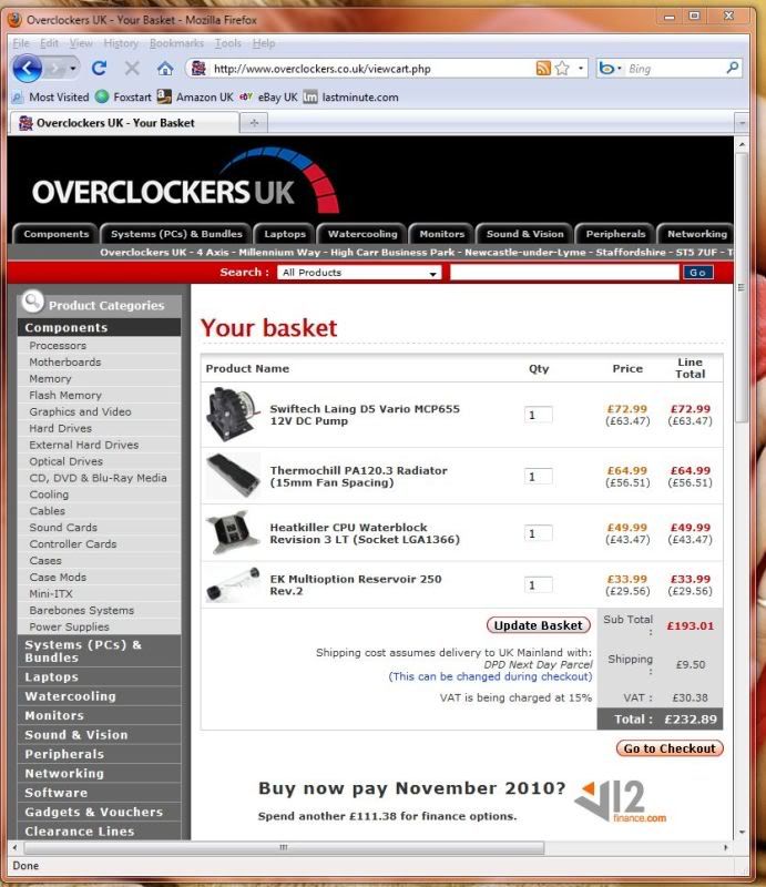

Ive been thinking of going the watercooling route on my i7 rig, ive been looking at a few bits and pieces for this, thinking of moving away from my current akasa eclipse62 to the corsair 800d. Had a look at the following components for a water cooled system, now the main part that confuses me is tubings and connections, what would be the best size of tubing and connections to go with this. Ive only looked at components for the cpu to start with as im unsure on my next graphics card purchase, either a second gx 280 or nvidias next high end offering.
Those parts should be great for cooling an i7.
Regarding tubing, if you are using barb fittings, then you are best to go with 7/16" ID or 3/8" ID tubing over 1/2" barbs, whereas with compression fittings you will need to match the size of the compressions to the size of tubing, so you would use 3/8" ID 5/8" OD compressions with 3/8" ID 5/8" OD tubing.

Tubing can be summarised as size doesn't affect flow rate, normal choice is 7/16" over 1/2" barbs with jubilee clamps. Tygon is worth it for the bending radius, coloured tubing with deionised water much better than clear tubes with dyed liquid.
Compression fittings are basically barbs with jubilee clamps built in, they're pretty but prone to tube twist and gradually winding themselves out of the blocks. The tube size has to match the compression fittings exactly, 1/2" tubing with 1/2" barbs or 3/8" with 3/8" etc. 11/8mm is difficult to source pieces for.
The D5 is excellent. I'd want the ek top for it, in order to use the same barbs with it as with the rest of the system. I don't trust plastic barbs. The DDC is the other option, again with a top, but either will do you proud.
The reservoir is convenient for filling but not required, a T piece with a length of tubing and a fill port/valve on the end achieves slightly lower temperatures and a system which reacts faster to changes in processor load as there is less water in the loop. Connect it just before the inlet to the pump. A second one to empty the system is a really good idea if you don't want to have to turn the case upside down to get the liquid out, I've run a line down from my graphics block with a valve on the end.
This thing is threaded both ends, I've got a blanking cap screwed into it as well as the valve closed because I fear leaks. Can do both fill and drain lines for well under £34, gaining more space in the case, better temperatures and the ability to drain the system. The drawback is that it takes longer to fill as you have to repeatedly pour water into the line rather than fill the res and wander off.

Can I ask the OP why he has chosen the longest of the EK multioption res's? If you are going to use a separate res then it doesn't actually need to be that big to do its main function which is to assist with bleeding. You may get very marginal benefits from having a slightly higher volume of water in the loop in terms of slightly taking longer to reach equlibrium temperature, and some say there is **slightly** less pressure drop compared to a smaller res, but weigh that up against the space it will take up in your case. In reality the Swiftech micro-res will do exactly the same job as that 250 behemoth. Have a look at the image gallery for some examples of how this big res is mounted.

Thanks guys, ive been doing a bit of reading on watercooling, (pumps, barbs, compression fittings etc) its a bit baffling (but in a good way) im ordering the 800d case next week to replace my akasa eclipse 62, ill still be cooling my rig with my current TRUE black until i get the parts for a custom water loop.
If you buy a £20 Omega top for the Eclipse and drop back to a PA120.2 (15mm spacing) radiator you don't need to change the case and you'll still get excellent performance cooling for the CPU.
Also - a combined reservoir/pump set makes installation so much easier and these days the Primochill Typhoon III and the XSPC dual DDC bay reservoirs mean you can have the best pumps with neat 5.25" bay installations.
