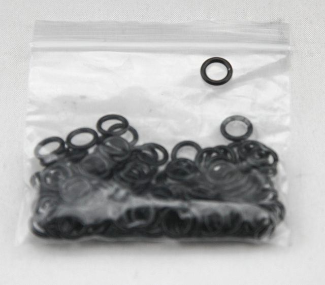

Included is a quick start guide that lists more of the specs and features, a set of 1 mm thick O-rings (bounce characteristics suggest Buna N rubber) to lower the travel distance and reduce the bottoming out noise profile of the keycaps, a sleeved USB type A male to microusb male adapter cable which is routed such that it extends outwards into the keyboard from the microusb port as opposed to away from it (review samples had it the other way round and it interfered with right hand mouse users, so I am glad to see CM has changed it for production models) and a keycap puller which has a thumb rest for grip.

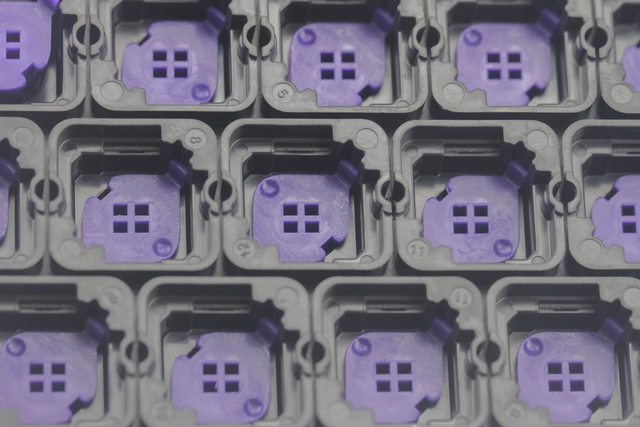

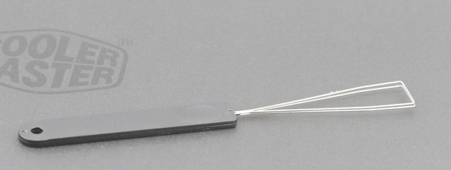

Using the included keycap puller, one can see the Cherry MX compatible stems here in a purple color. The actuation point here is a mere 1 mm of travel while the key bottoms out at 4 mm. So touch typists can make very good use of this and get a relatively silent operation. For those more prone to bottoming out keys, the included O-rings lower the travel distance to 3 mm while also lowering the “clacking” sound of bottoming out. Here’s what the keys (the larger keys included) sounds like when bottomed out: Click here

Using O-rings sounds somewhere in between but I definitely encourage people to give touch typing a chance here. I started out bottoming out all the keys and now I type quieter, quicker and more accurate with this. The keys require exactly 45g of force for actuation putting these on the same level as the Cherry MX Red switches which are a gaming favorite for the linear response and relatively low actuation force, and this is also where gamers can relate to the board. In fact, calling the typing experience somewhere between a membrane keyboard and a Cherry MX Red switch keyboard but at a higher quality overall would be just I feel. But once more- you really, really need to get a feel of these keys before making a judgement call.

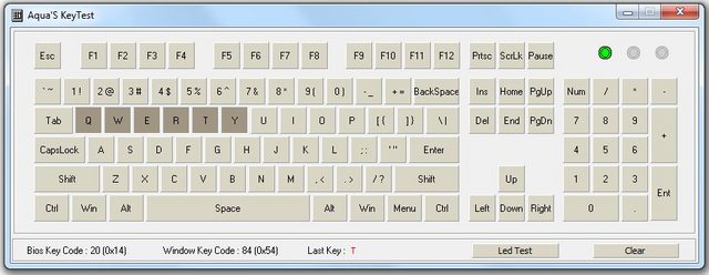

Before we open this up, here’s a demonstration of the N-key rollover via USB (in Windows OS, anyway):
The test was done using Aqua’S Keytest. In comparison, this is a standard membrane keyboard with 6 KRO:
Note that unlike membrane keyboards, or even some Cherry MX keyboards, this will simply not work over PS/2 with any USB to PS/2 adapter. So if you have a motherboard that doesn’t like USB peripherals during boot up (x99? Are you listening?) then please be aware of this. Now let’s take this apart.
