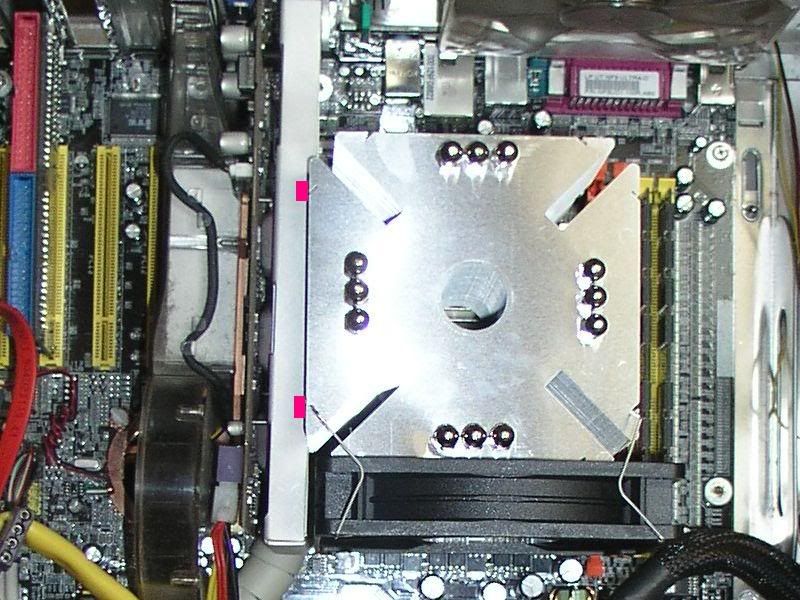

Got my Ninja+ its doing a great job even though its tight up against my video card :eek:
you can actually cut of some of the metal on those arctic cooling backplates, i used to use one of them for a X800XT i never quite worked out why they used so much metal on top of the card, neway glad its working
edit: that mobos got a weird layout your RAM is above your CPU! thats why the socket is so clost to the PCI-E :p
I noted that when I was putting it all together but was too eager to get to get up and going. Will defo look into it though when I get opportunity :)
2 notches just where the red blocks are would let the fan clips in and let the video card straighten :)
i went the whole way and cut the entire of the metal overhang off, used a hacksaw with a metal working blade, did the trick nicely, i needed to do that because i used to use it in an abit digidice where the hdd caddy was above it and it rested on the top of the backplane, hack it off then no more problem! :D
