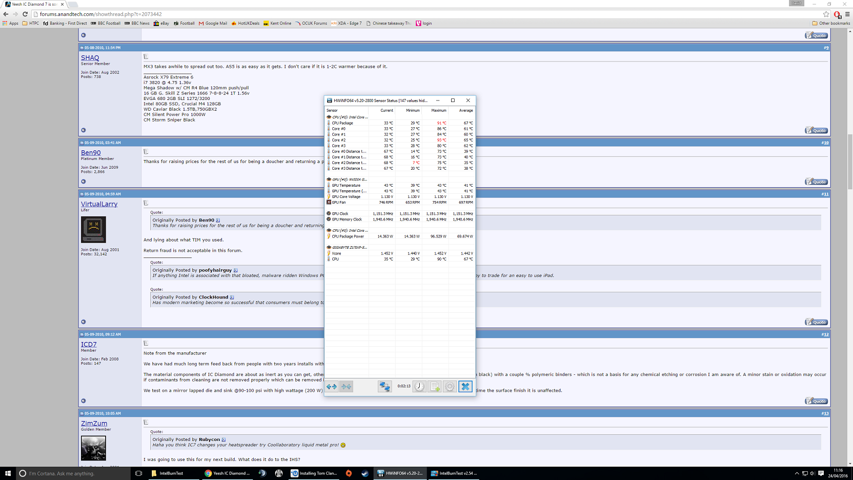

Anyway I picked up some CLU and applied it onto the die and I'll let the pics do the talking.
Diamond IC just after repaste:
Noctua NT-H1 1 day after repaste:
CLU just after repaste with Diamond IC ontop of the IHS:
The Diamond IC and NT-H1 performed almost identically just the Diamond IC seemed to take longer to pump out.
Now only time will tell if the CLU suffers any drop in performance but by looking at those temperatures so far I'm extremely impressed.
