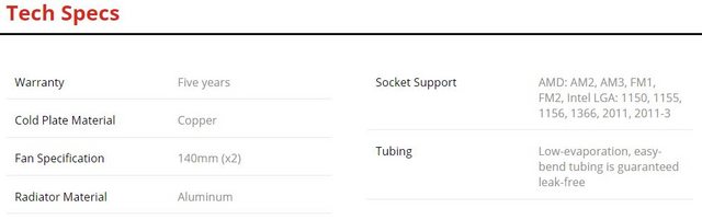

As always, here are the specs courtesy the product page:
As with the H75, the first thing that I see is the 5 year warranty for the cooler which is good to see. We also see the usual copper cold plate, aluminum radiator construction here as with other contemporary CLCs (closed loop coolers). The coolant used inside reflects this and I want to say prevents galvanic corrosion for the entire duration of the warranty period, but without having taken one apart myself I can’t be sure. We also see the cooler compatibility with just about any socket a consumer can make use of with this product. Lastly, and possibly one of the more exciting things here, we see that the included fans are high torque 2100 RPM (+/- 10%) 140mm sized fans. There is a dearth of proper performance oriented 140mm consumer fans out there so bring it on! Let’s now begin taking a look at the package now.

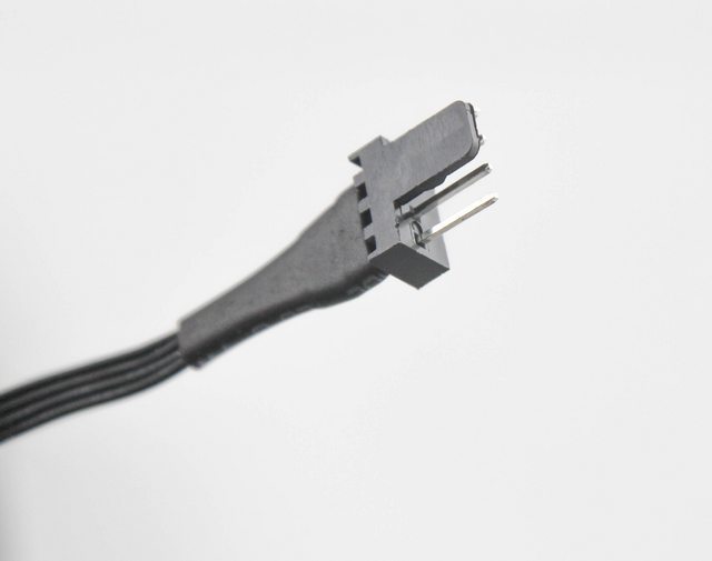

Back to the splitter for one more minute:
There are covers on the 4 pins there so if you can’t figure out where the fans hook into- well, now you do!

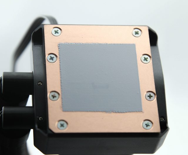

Now for the cold plate:
There is another protective plastic shell here keeping the pre-installed TIM in place.
The copper isn’t lapped to a mirror finish but I can’t really say if that has a tangible effect or not at this point. Both the cold plate and the TIM are square in shape as opposed to the Asetek offerings. The issue I have with pre-installed TIM is that you are limited to all of one installation, and I would really prefer having a tube or satchet of TIM on the side instead. Another potential issue is that you are now forced to do a one size, fits all solution irrespective of the CPU socket the user is on which doesn’t work out great as we will see later. But then again the TIM used is a Dow Corning grease which costs a lot (one SKU for example costs $950 for an 8 pound/3.6 Kg bucket). Before you go get a calculator to see how much a 1 gram tube would cost, don’t- large scale economics do not work out on the small 1-3g TIM tube scale and this TIM is quite a lot more expensive compared to the usual aftermarket ones you can purchase. So I understand where Corsair is coming from as well since most end users only really use the cooler with a single CPU. The 8 screws on the cold plate are flush with the copper surface and far enough that they do not influence the contact with the CPU IHS.
