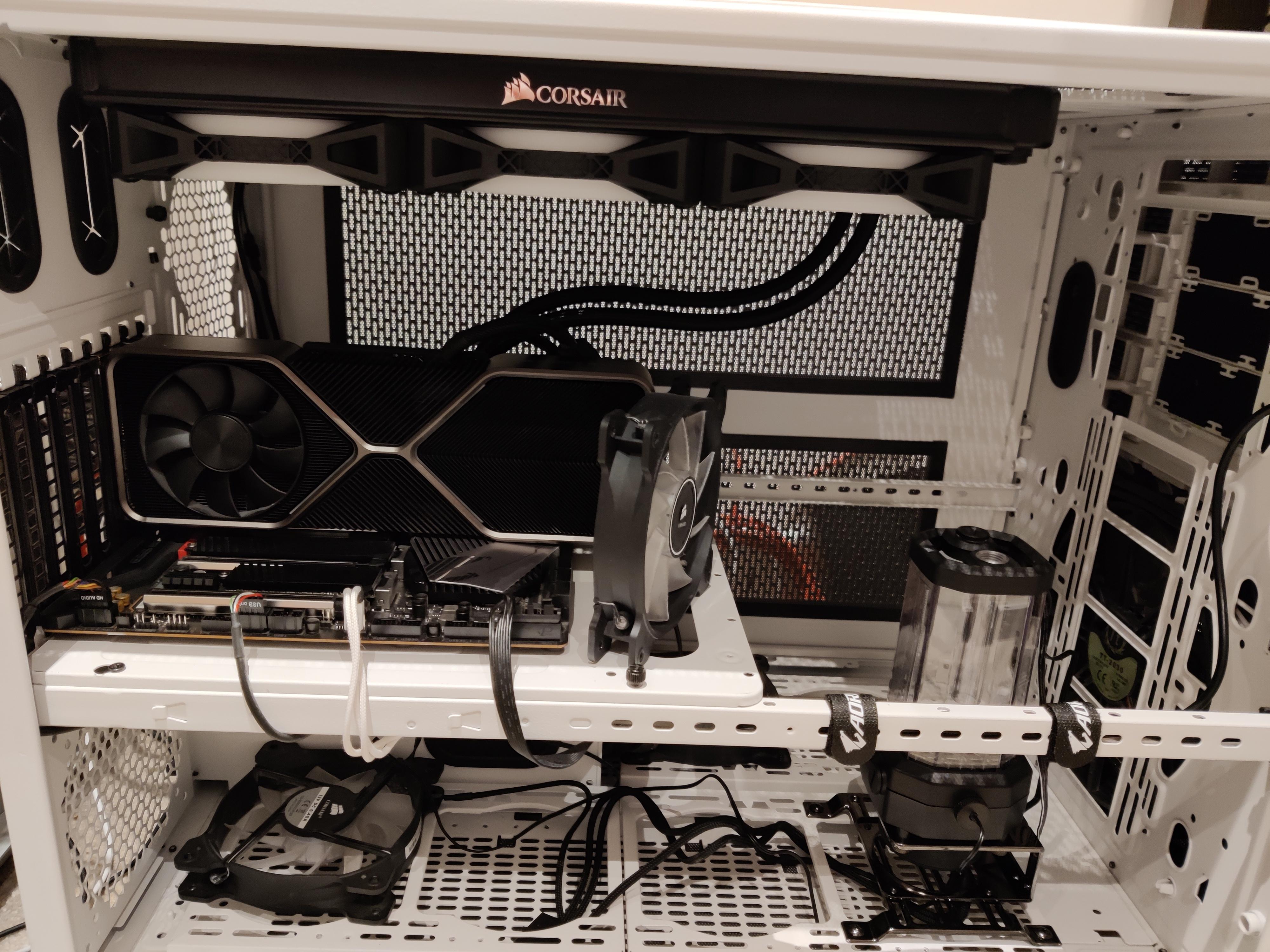

So I'm thinking of mounting my pump/res combo here. With the radiator above as you can see.
Tell me why not? Other consideration was on the front of the case.

Nothing wrong with the pump/res combo there, the only consideration is if you want to see it through a side panel? Not sure what the case is so no idea if any cut out covers anything below the mobo tray.

So. Currently I have the existing CPU AIO behind the rad you can see at the top. The case is massive and can handle 2x480mm rads up top. You can see the tubing for it coming down to the CPU block.
The panel that goes on this side is a clear window. Case it a core x9.
Tempted just to get another rad and fans and do the CPU too. But that would be shelving an expensive aio with little resale value and spending a chunk on rad and led fans.
use the fans from the AIO - order of the components doesn't matter

Ah, I see now. It wasn't super clear that it was double depth from the picture.
As said, loop order doesn't matter, especially when you're cooling a single component.

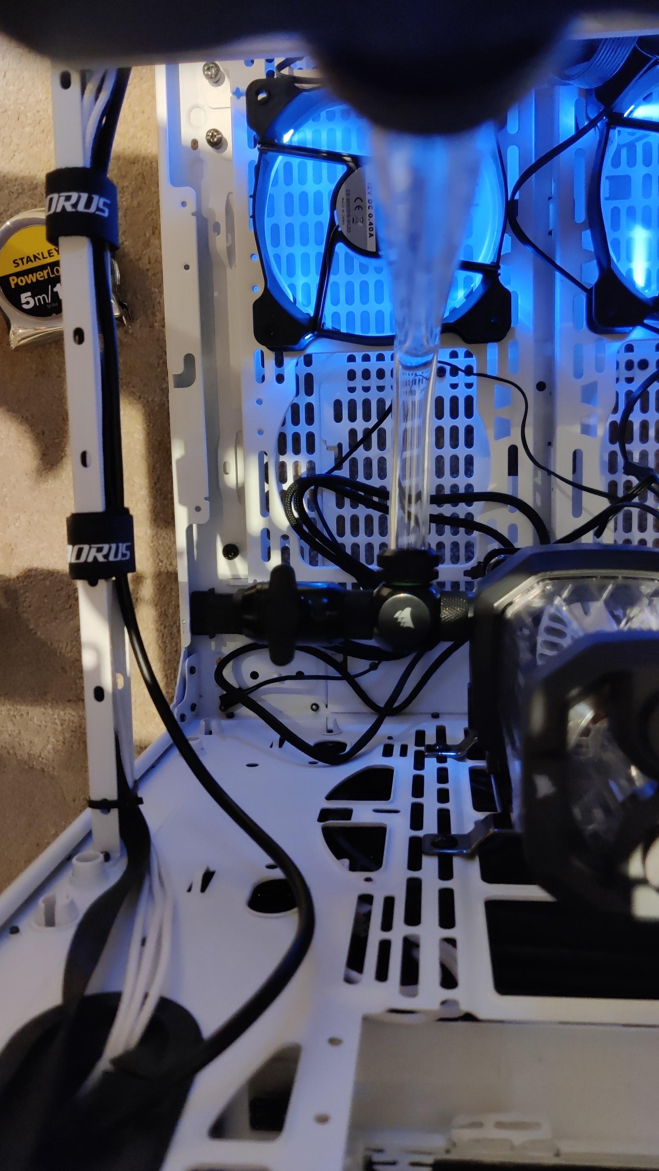

Enough for today. Moved pump and Res to the front of case, but facing out towards window. Added y splitter and valve for drainage.
Hooked up one RGB fan and ordered some extension cables for the fans and one for the pump/Res so I can reach and plug it into the pro commander.
Decided to bend a pipe. 2nd attempt and I know what I'm doing.
Am I allow alittle wiggle here it's slightly pulled to the side... that's looking down from the top mounted rad, the pipe comes out from the pump.

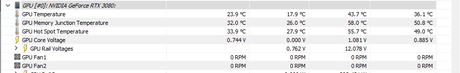

13.1 degrees delta to gpu on the hotspot. this use to be 10c.
I didn't like installing the block. Two noted challenges with my 3080 FE and this XR7 corsair block.
When putting the pcb onto the block I was unsure if the block posts should come through the pcb to align on the back edge of the PCB. I decided that they didn't. and the PCB lay on top of the post without coming through the pcb.
Once attached and screwed down, I noticed a couple of the smaller edge pads actually didn't make contact.
These are the two that clear have a fraction of a mm of gap, as the card is also for 3080TI I wonder if that is the difference.
The temps suggest its all working though.
