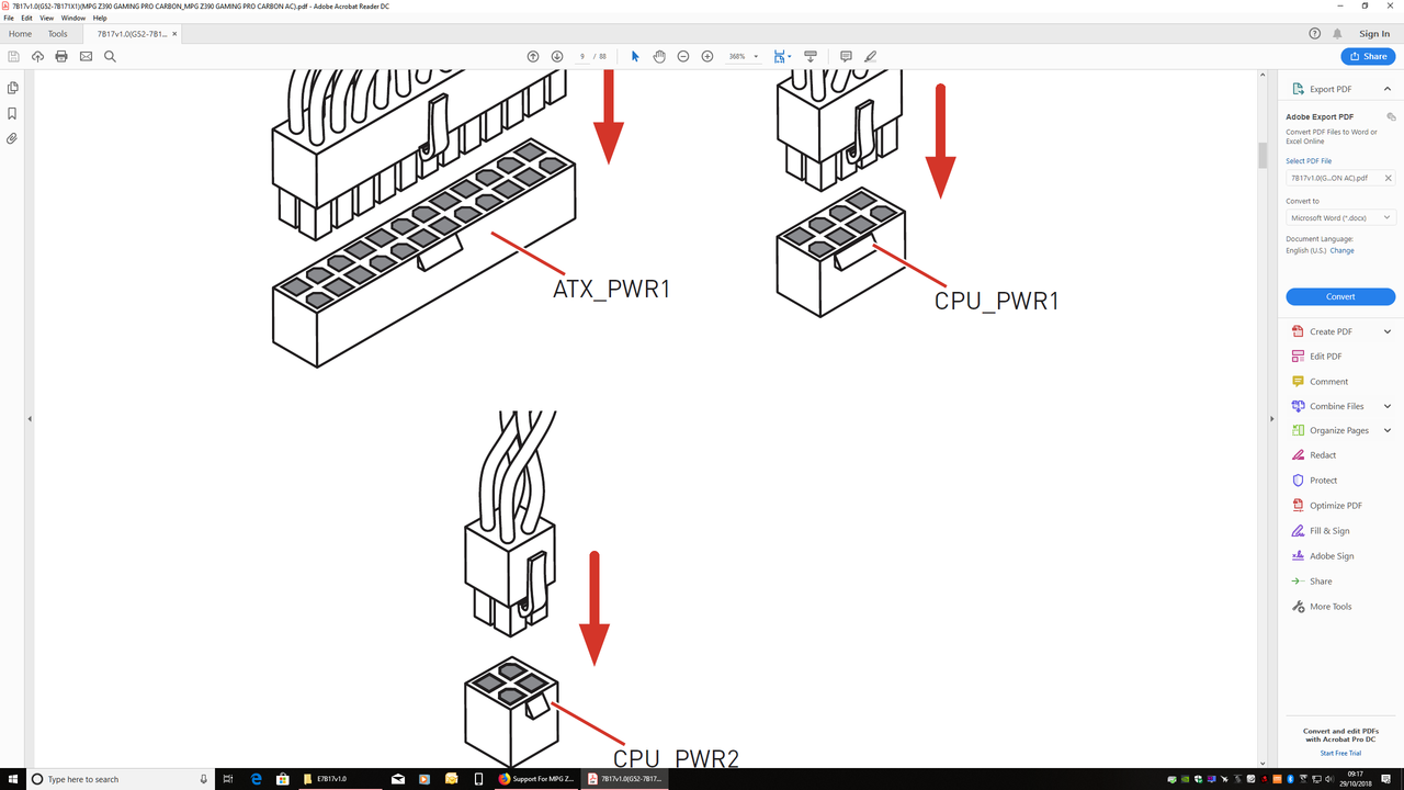

this is what you should have on that board. If that is correct then maybe the plug on the psu is wrong.....never heard of that before though
Yes, that's right.
