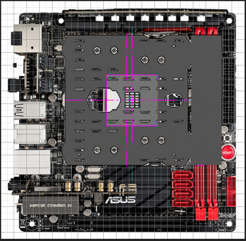

Great looking cooler, which performs better than the Noctua U9S (Based on the comparison with Antec Kuhler on Niktech) that would fit a good number of ITX boards. But I'm fairly confident it won't clear the VRM board on the Impact.
What is the distance from mounting back plate holes to VRM board?
Macho 90 is 51mm from center CPU to sides. 1150 mounting holes are 75mm square or 37.5mm from centerline. This means we need 14mm from mounting hole to VRM.
The board with 10mm grid overlay:
I think there is 15mm from centre hole, so it may squeeze beside the VRM.
It will also push against the Sata/power cabling of the Blu ray drive.
I think the problem is the fan will not clear the Audio daughterboard (Just above the word Asus on the black heatsink at the bottom) if mounted PCI-E side, and I suspect it wouldn't clear the USB headers if mounted back side.
I overlayed the cooler with fan. You can check the scaling of cooler as102x102mm I did fan 102x25mm, but it is actually 92x25mm
I appreciate your efforts to help, but I didn't suggest to mount the fan on that side as I have the blu ray there. The fan would clear the drive in your drawing (Which reaches about to the A in the red start button, 90mm above the socket), but not the cabling even if I were to use angled connectors.
