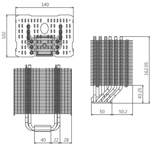

What cpu coolers are suitable and will fit into my case? I have a dvd drive installed if that makes any difference.

CPU socket is very close to PCI slot on that board.
ASRock Z77E-ITX is 170x170mm. 48.7mm from RAM slot and 47mm from PCI-E slot to center of CPU.
Thermalright Macho HR-02 will fit turned sideways.. but only 22mm between cooler & GPU for fan. Could put fan on right side of case or use 120mm fans on front/back of case.
