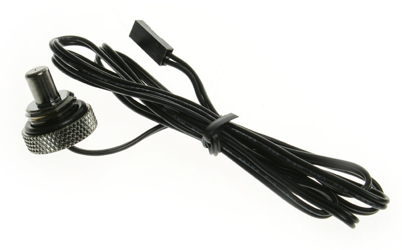

You are reading cpu and gpu temps which will always be higher than your water temp so you are safe. If your gpu is only hitting 46 degrees then your water temp is probably in the low-mid 30's. If you have a spare port in your reservoir, distro plate or even a radiator then you can easily fit a temperature probe to keep a eye on your water temp. I have one in a spare port in the base of my reservoir and it has a LCD screen displaying the temp but you can get others that connect to a temperature header on the motherboard but not all boards have these. Some examples of different types of temperature sensors are here, here and here. The first is a temperature sensor that screws into a unused port anywhere in your loop while the wire goes to a header on your motherboard or fan controller. The second is basically the first one connected to a "T" piece which converts it to a inline sensor. This type requires extra fittings though as it goes where you would normally have a straight run of tubing or you fit it to a inlet/outlet by using a male to male adaptor and then fit the fitting that you would have put on the inlet/outlet to the other side of the "T" piece. The third one is a true inline fitting and would normally fit on a inlet/outlet anywhere in the loop. It doesn't really matter where you fit the temp sensor as there is very little varience in temps across the loop. I used to run a pair of inline temp sensors, one on the inlet to my pc and one on the outlet (my rads are external). I found that the difference in temp before the cpu and gpu and after only varied by 0.6-1.2 degrees C and it wasn't worth monitoring so on my next rebuild fitted my current sensor to a spare outlet on my reservoir. I manually set my fan speeds to keep my water temp below 24 degrees C which works out at a silent 780rpm for my fans and for most of the year don't have to adjust it, hot periods are the exception. Currently it is sitting at 15.4 degrees C (outside air being drawn through the rads).

ps.. technically the AC inline is not a true inline as its just a normal temp sensor with a removable cap fitted on top. The sensor 'tag' wraps around the outside of the fitting and a cap secures it in place. Even then not fully secure, as a slight tug the cable disconnects (i have one). Prefer all the others tbh... but all do the same thing regardless
