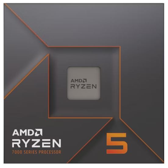

Moving to a newer platform such as AM5 will require you to change it out either way, something like this would be a huge uplift and offer a lot of upgrade potential:
My basket at OcUK:
Total: £387.97 (includes delivery: £0.00)​
You might also need a new heatsink and fan depending on what you currently have and whether or not you have an AM4/AM5 mounting bracket. That said, you can get a Thermalright Assassin King 120 for around £15 which would be more than ample for the CPU.
£140 (incl. VAT)
£125 (incl. VAT)
£219 (incl. VAT)
£161 (incl. VAT)
If you want something cheap, this would do it (or a Ryzen 5600 and equivalent motherboard), there's a CPU cooler in the box and you re-use the current DDR4 memory:
My basket at OcUK:
Total: £158.98 (includes delivery: £0.00)​
Gray2233's suggestion is much more performant and will have better upgrade potential, but for a 4060 the above would be sufficient and much faster than the i5-6500.
