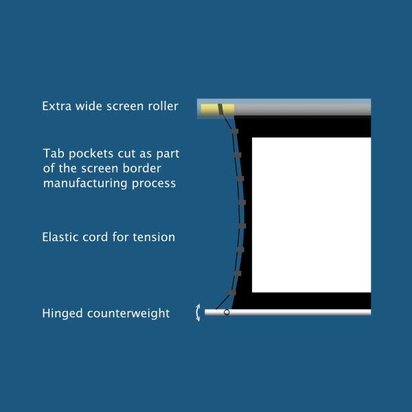

Here's how roll-up tab tensioned screens are constructed...
If you want your screen to roll away again then you have to avoid anything that's going to create significant bulk. Eyelets are fairly thin, but once you have a few wrapped around the screen roller then it'll be a problem. The result will be more distortions in the screen surface and you being worse off than before.
Have a think about doing a similar trick to the screen manufacturers. Get some reinforced vinyl and cut some strips. Fold them in half to form a tab, then glue the flaps to the screen with some suitable vinyl glue.
Use elastic cords for the tension between the vinyl tab loops and the wall.

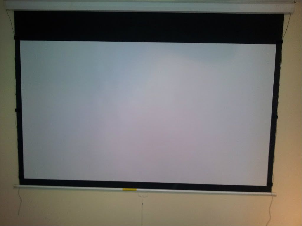

Ok I have manged to do it and it looks mint!!
Mine will be left down full time so I didnt have the worry of it going back in its case
Just to help anyone else out.. This took me a total of 20 minutes

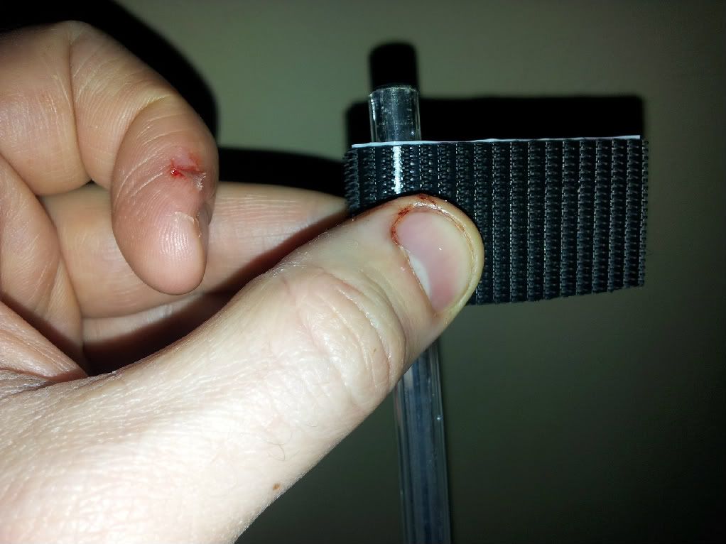

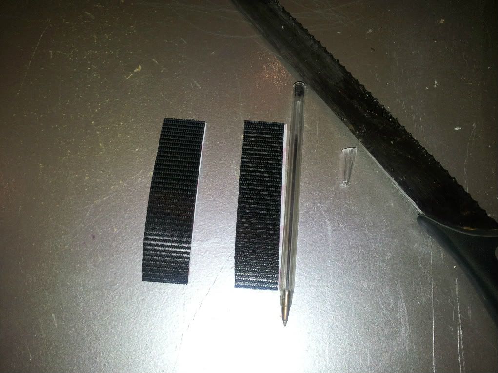

1 - You will need these items, you can buy velcro strips from most places
Plastic pens x2 to use the tubes
Velcro strips
I used a bread knife - be careful I cut my self lol

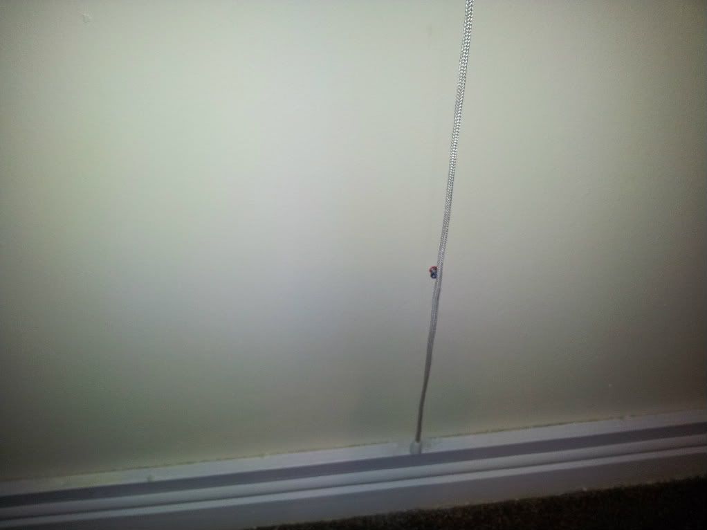

Here I have put a screw in the wall and plan to wrap the string around it until its tight to pull the screen even more

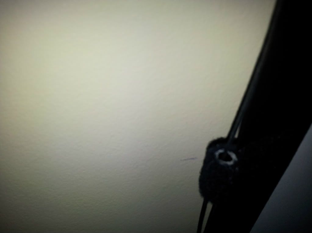

Here is the end result - I havent pulled it all tight yet as want to leave it for 24 hours for the adhesive to dry just to be safe
