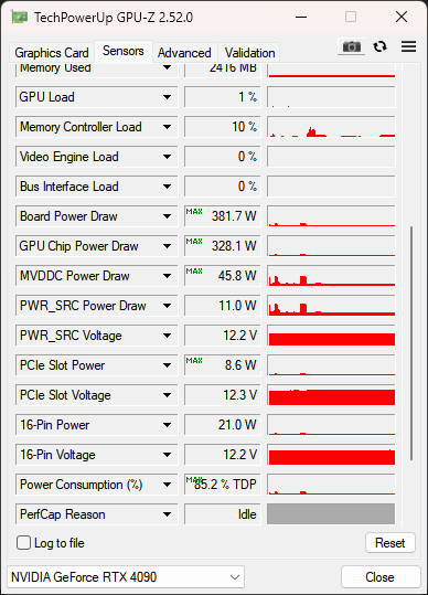

I'm getting this crash 4 or 5 times a day, not sure if its PSU related or not, the PSU is a brand new Corsair HX1000, the CPU a 5800x3d
Im thinking Ill swap the new HX1000 into another build and buy a 1200+PSU for the 4090 rig?
Make that 6 times it just crashed again
