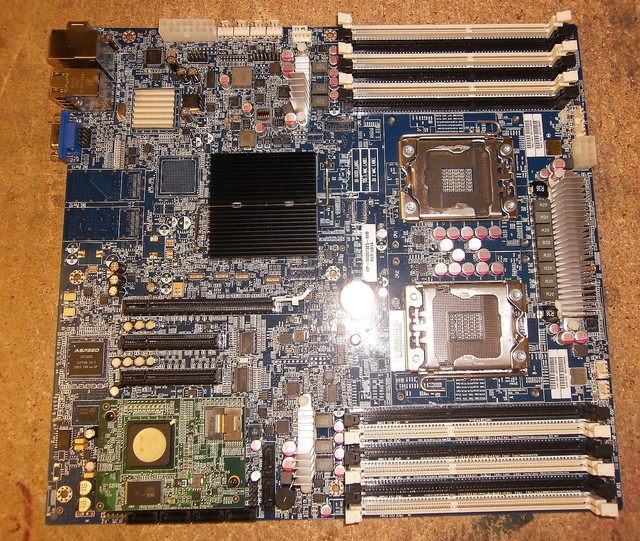

Let's say in theory I have a server board and instead of having a 20+4 pin power it's using a 16 pin for the mobo power, are there any UK based companies who I could ship the board to and have them create a 24pin to 16pin for said board and how much would I be expecting to pay for something like that? Seems like a rather easy job but I don't own a multimeter or anything like that and knowing my luck I'd probably **** it up so I'd rather just pay to have it done :P
There are adapters often available for most boards on popular action sites, at minimum you can find the plastic connectors for almost any Mobo power plug (lenovo workstations and servers have custom 10 pin connectors for example). I had to get the chap in my local phone repair shop make me an adapter for an HP z worstation board - only cost me a tenner and I just had to find the Mobo manual and compare the connectors to an ATX 24 pin psu.
The guys on the servethehome forum have some great posts in their DIY section for most server/worstation boards too (wiring diagrams etc)
You could ask James @pexonpcs he does a lot of customer psu cables
I asked Pexon and they were unable to do it.
Unfortunately there seems to be little to no documentation for the board, seems it was designed to be a cluster based rack scenario. The few pictures of the internals are pointing to a few PSUs I can find to buy but they come with 24 pin cables as opposed to the 16 I need and tend to be lacklustre at 476w.
Any other ideas?
SGI Rackable C1001-TY3, board seems to be a pull from a 1u server. The psu I've seen in most pics is the model number ECD13050001 but the few I've found for sale don't have the required connector.
If I had access to a multimeter how exactly would I read the voltages needed from the boards connector or is that kind of thing not possible without actual power running through it? I figure it'd be pretty easy to turn a cheap atx extender into the required connector but the voltages have me at a loss
Just a fun side project I enjoy playing around with older hardware, boards about 40 quid, two decent Xeon chips about 40, server ram is cheap as chips etc just trying to power it is the problem.
Actually, better thought! Assuming the CPUs you have are lga1366 get a X8 series supermicro board - though here be dragons as many of the 2 socket boards are a proprietary form factor that is a bitch to mount in standard Eatx cases, super micro refer to it as "Enhanced Extended ATX"
Honestly I haven't ordered any of it yet, was wanting to be as sure as possible I can make it work before ordering even if it'll be sub 100 for the board, a chip, stick of ram and a heatsink just to test. There's a few supermicro X8's up on the bay but they're either an odd form factor or just cost too much. Only reason I wanted to do something like this is atleast in my eyes LGA1366 has some of the best price to performance atleast on the used market, plus the board is fairly cheap.
here's a few flicks of the board from various google/auction listings
there is someone selling a psu of the same model number that looks to have the required connector but itll be somewhere in the region of 60 quid shipped from america
if anyone can make heads or tails of that then any advice is appreciated :P
