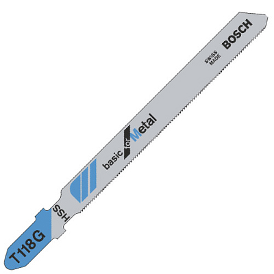

I've got access to a jigsaw but I'm not sure which blades to use for cutting a window in my steel Shinobi side panel. Could someone who's used a jigsaw to mod a side panel tell me exactly which blades they used?
Cheers fella's.

Update:
After a fair bit of research I decided on these blades:
Hopefully they'll do the job. A bargain as well. £3 inc delivery for a 5-pack.
