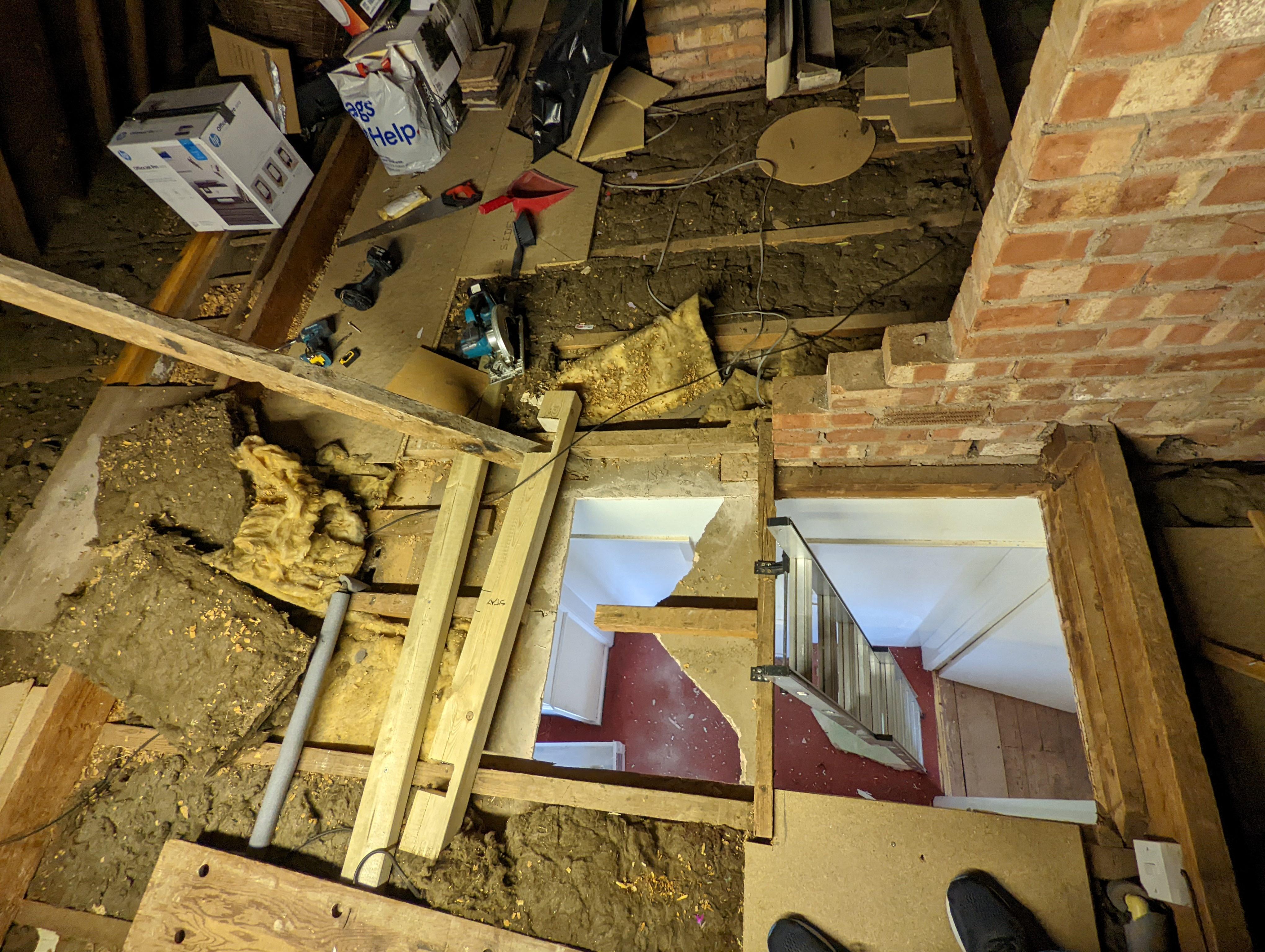

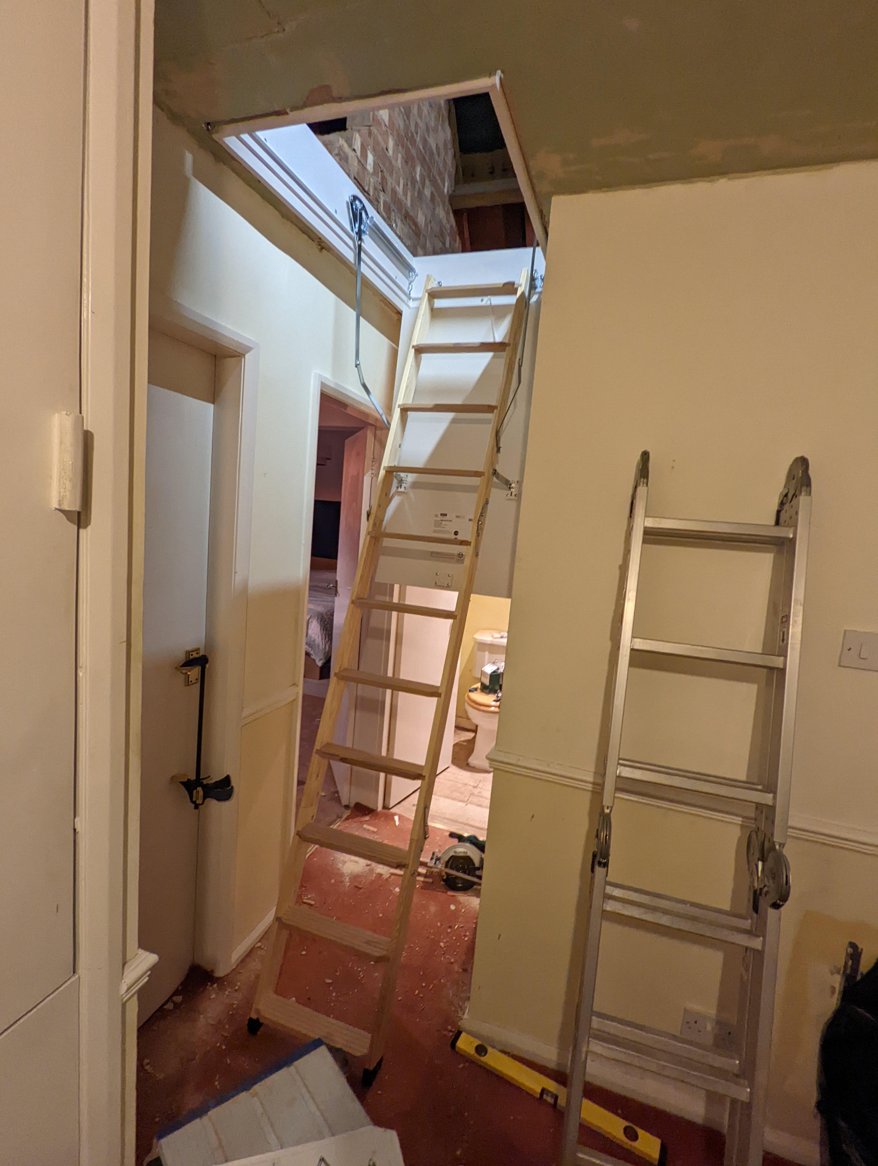

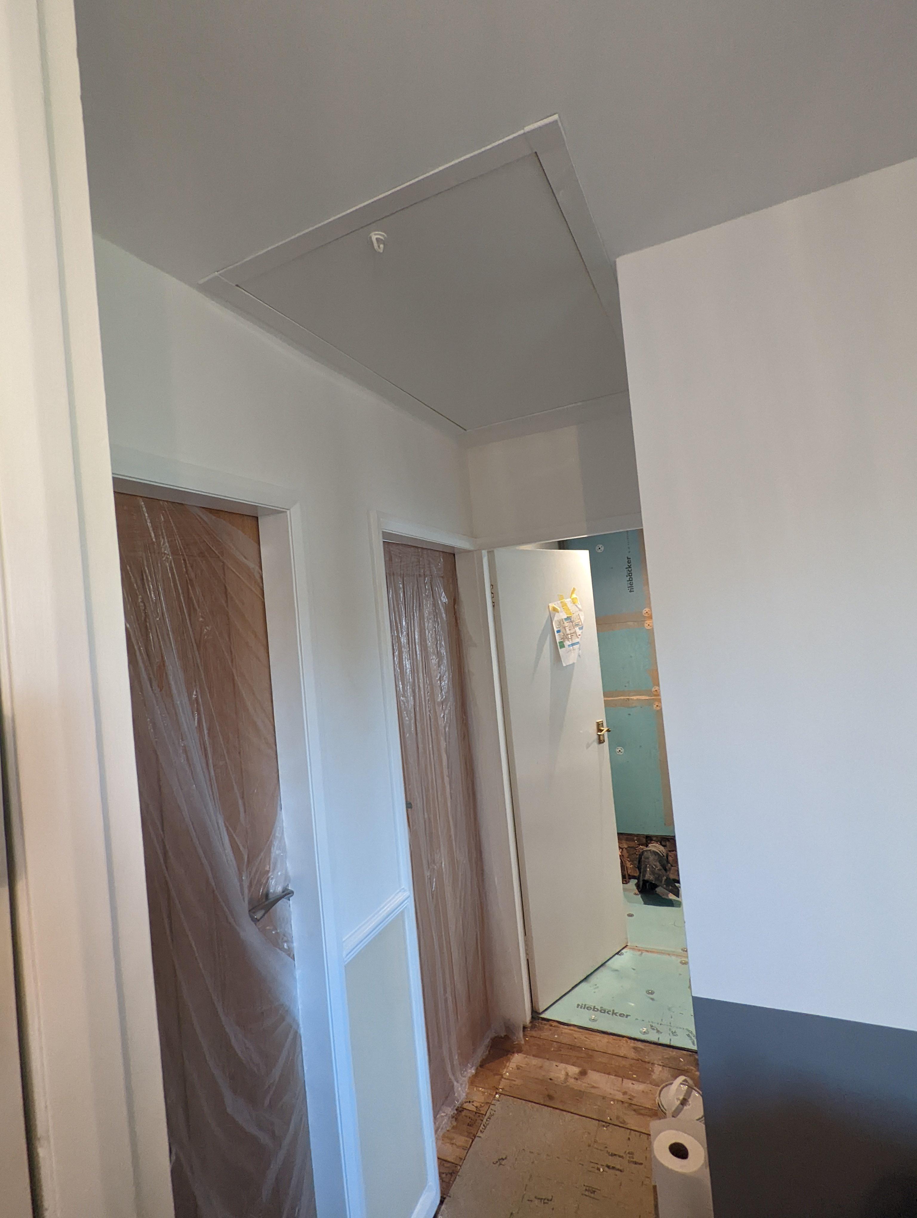

Aye thats how I did mine. Pretty much doubled the length of the opening
Pictures
(this was before plastering and decorating)
Now (not quite fully decorated)
