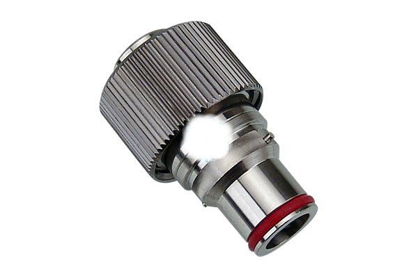

Well, after coming back from my dinner there's coolant leaking from the join of both quick disconnects, 1 of which is already a replacement..
*le sigh*.
Can anyone recommend any that work? these are the phobya ones. pretty sure ocuk don't sell them, but i'm thinking koolance? $$$ though..
thanks. mind boggling finding the right pair though. ah well.
I guess since the phobya pairs i bought are less individually than half a koolance pair, this is going to be one of those "buy cheap buy twice" situations.

@craac the only o-rings on the vl3n series QDC fittings were on the male half of the qdc mech, none on the compressions. Do you have the same ones?

Thanks to that and the koolance qdcs my pump no longer buzzes or struggles. I think those rubbish phobya qdcs must have been really restrictive alongside the airlock, because atm I can hear sloshing in the rad (d5 on 5) so I still have lots of bleeding to do.
Not a single drop from the qdcs either :).
