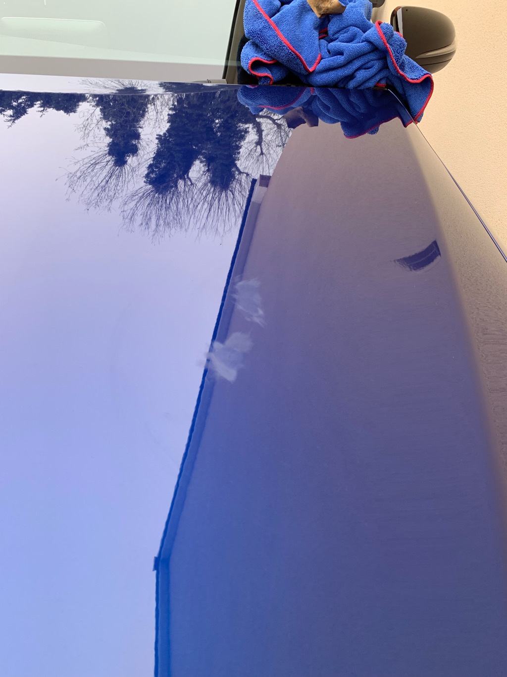

Had a massive bang yesterday while driving to Portsmouth which I assumed was a stone hitting the windscreen, but after having the car detailed today, he noticed a rather nasty stone chip
I’ve emailed a couple of reputable mobile places who all said that for a totally perfect finish, it will need a full bonnet respray.
For now, I’m not after a 100% perfect finish, just to minimise the nastiness of it. Would a touch up kit be worth it? My detailer said he’ll reapply the ceramic coating to the area if needs be but what would the most simple yet visually acceptable way of fixing this?

The way i do it.
Use a cocktail stick to fill the chip so its proud.
Then use wet and dry on the end of something to sand that flat.
Then polish.
Unless you know where to look it wont be noticeable.
If that needs a respray you will be respraying your car a lot.

I went down to Mercedes this morning and picked up some touch up paint. Used a cocktail stick to fill what I could then touched it up with a couple of other layers. The biggest chip looks a bit rough where it was harder to touch up, but the smaller two are nice and tidy. Bought some 2000 grit wet and dry sandpaper and will go to town on it after 24 hours then polish it. Detailer has said he'll take a rotary to it if needed next time he works on the car but I'm confident it should look a lot better after I go at it

Did the touch up contain clear coat?
So taking sandpaper to your paintwork is a little nerve wracking...
From the wrong angle, you can see a slight change in the reflection, but you have to be looking for it and know what you’re looking for.
It’s by no means perfect, but it’s a hell of a lot better than it was

My detailer said not to worry about sanding, as anything could be fixed and he’d be happy to look and give it a go for nothing providing I hadn’t completed ruined it. So that helped massively, otherwise I’d have probably bottled it.
He’ll still need a pass of it with his machine polisher as you can see a shift when moving over the paint slowly where I’ve not been able to get 100% of it out by hand. But the result I wanted was that you wouldn’t see it unless. I pointed it out, and I’ve definitely achieved that I think.

Definitely did. When I’d finished sanding and took a look, I was convinced that I’d gone too far and done some damage, looked horrific. But ScratchX and some serious pressure got the majority out.
