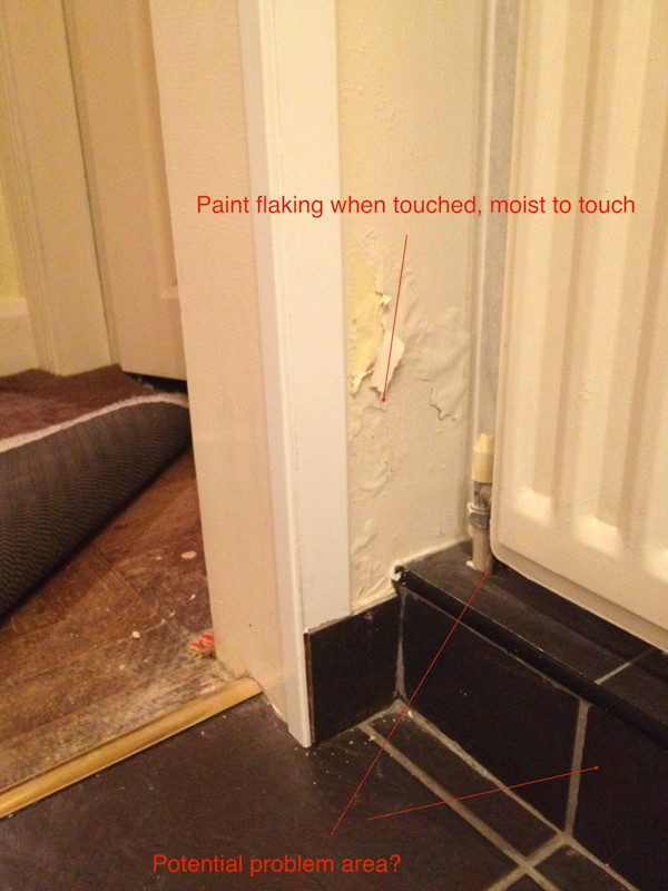

As I continue to rip this house apart I've come across an area of concern. Looking for advice, not sure where to start on something like this.
The area in question is shown on the flooplan below. It is in the corner of the former kitchen, nothing to note on the floor above in that position, and the damp appears to be bottom-up anyway.
Few pics of the problem spot:
My plan is to remove the tiles and boxing from the potential problem spot above and hope its a leaky radiator pipe.
However - if its not that, what are my option? Any ideas what could be the root cause - faulty DPC?
How would you tackle this?
The way the pipe work is done in dinning room is also naff going through the skirting.
Leaky pipe high on my list, mortar can rot copper pipe, also dodgy soldering?
I would remove boxing carefully & see what you find & then report back.
Thanks night glow, I'll see if I can get the boxing off without trashing the place. Any tips on that front?

Agree it could be internal damp, but rising damp would usually leave a stain, also salts present you would see, I would eliminate the central heating pipes from any leaks first.
Could have easily snicked a pipe with a screw, panel pin fitting the boxing around the pipe work.
As an update. Rad is fine, DPC seems to have failed.
I've removed the radiator, skirting (major ball ache) and knocked 1m of plaster of all along the wall.
