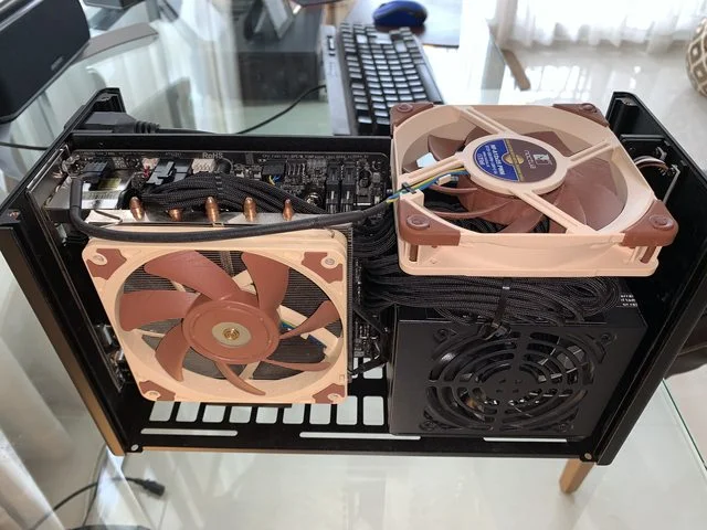

hopefully this works, used imgur
https://imgur.com/u838TLX
https://imgur.com/QFKKaqv
https://imgur.com/8tkSogp
https://imgur.com/KeY25iJ
https://imgur.com/PhrFN3P
sorry for the quality, didnt have the best camera or light to work with
but super happy with the outcome, to cram in the amount of hardware that i have is really something else,
full specs
amd ryzen 9 3900x (stock speed 3.8ghz pbo enabled)
32gb ddr4 3600mhz speed corsair lpx (2*16gb 18,22,22,42, 1T)
asus strix x570-1 gaming itx mainboard
corsiar sf 750w sfx platinum rated modular psu
samsung 970 evo 250gb m.2 ssd (boot drive for windows)
samsung 860 evo 1tb ssd for games and storgae
zotac 2 slot blower rtx 2080 ti gpu
dan a4 v4.1 itx case
astek 645lt 92mm aio water cooler for cpu
added a aditional noctua 92mm fan for cooling on the cpu and motherboard areas
OP
28 Aug 2017
2,779
United Kingdom
the extra fan is a 92mm noctua and yes it does a fantastic job cooling down the mobo, chipset and m.2 especally, i noticed a 20+ degrees drop with it installed, sure the looks factor isnt there but i dont mind that, i care about cooling and a fan in this location does a really great job.
before the fan was installed my temps were
mobo around 60 degrees
chipset peaked at 81 degrees
m.2 would normaly hit around 58 degrees
after the fan was installed and tuned in a bit
mobo around 40 degrees
chipset down to 51 degrees
m.2 peaks at 38 degrees
so yeah definatly worth it for cooling XD

well guys and girls here are the hi res pictures of my dan a4 build
https://imgur.com/k7cCl2M
https://imgur.com/kGniMyG
https://imgur.com/VaIA12L
https://imgur.com/X4Dbg9F
enjoy XD
Looks fab, love the cable management. Really nice build, hope you feel chuffed.
