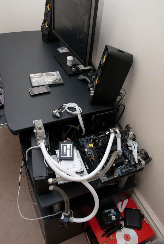

I'm just in the middle of building my new PC, well rather an old PC with new hardware and modding my old Lian-Li PC-1000. Since moving to a SSD, I now only have 3 moving parts - my DDC1 T (10W) pump w/ EK acetal top and two 7v Nexus fans. Needless to say, the DDC1 is now my loudest component and is driving me mad - and currently it's suspended by the tubing outside of the case and so not touching anything or causing vibrations.

You can see the pump hanging in the bottom of the image, its about 2 foot from my head right now. I have my new build setup like that temporarily until I finish the work on my Lian-Li. The noise that's annoying me is the low whine, not a vibration or anything like that.
As I said, it's literally hanging by the tubing right now so it's as decoupled as it can get :)
