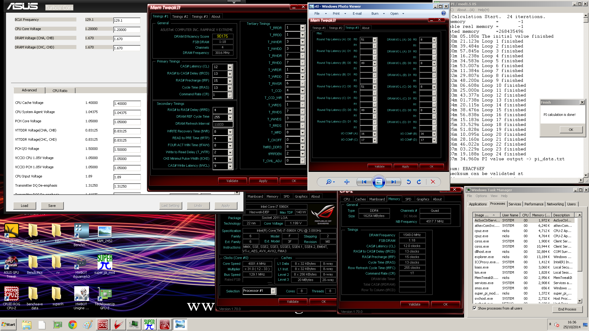

Absolute rubbish, take a look at my screen below, mine cost me £230 gskill 2666 kit, now show me some DDR3 that comes close to that performance for the same price, good luck!
Cpuz is showing correct speed of 3098mhz

lol 1.67 DRAM voltage, you're nuts :D
