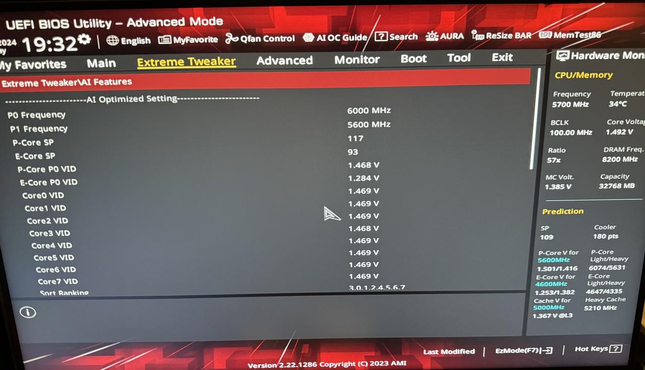

My settings for 8200C36 using 7200 sticks and the silver Apex linked above if you feel like having a go. Depending how well you cool the RAM you should be able get a higher TREFI, 262k is the max.
