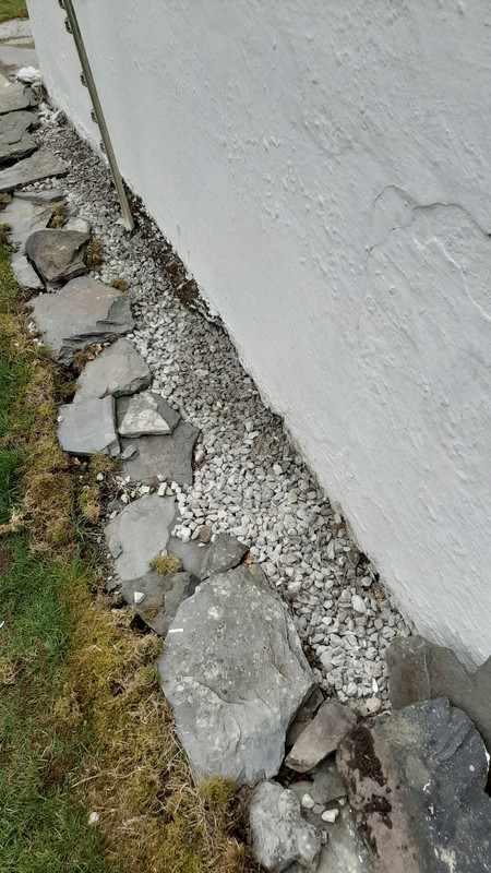

I'm looking at tidying up the edging around our house, currently there is stone down in most places but it's not a nice edging to the lawn.
In future there will be a path around one end with a log store and parking area.
I want to put some edging in with some gravel next to the house but more importantly, I don't want to trap rain water in the gravel or channel in under the house. It's an 1800s cottage and most is rendered thick stone wall without significant foundations or damp proof course.
Am I ok to concrete some stone edging in? Should I leave a gap for drainage or concrete right up tonthe walls?
Only looking for 6-8 inches of stone then some sort of stone edging.

My worry was creating a gully that held water against the side of the house.
I'd like a proper edging as currently most of the gravel is full of grass, other than looking messy it's a pain to cut.

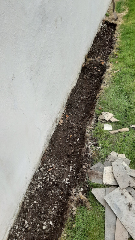

I may pull the edging out a little further so I can concrete it in without it trapping water against the house. Could I put a membrane down first that directs the water under the concrete? Thinking of the black mesh type that you put under gravel etc.
3 of the guttering down pipes just end in the gravel so I need to put some drains in for those, we have a marsh area that 1 down pipes goes to so I'll replace that with 4 inch and connect the others to it.

I don't really want to dig too deep by the house, I doubt there's any real footings under it.
