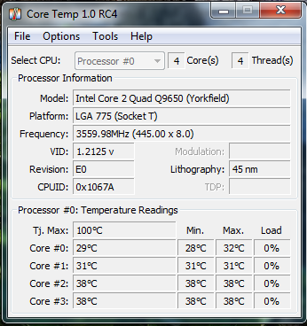

My Q9650 at idle usage has 2 stuck sensors aswell on core 2 and core 3 reporting 38C even now lol, even though my room is pretty cold :p
When load is placed on my cpu, then these sensors work correctly displaying right core temps
@OP seems like your core 0 and core 2 have stuck sensors at idle

That's perfectly normal. Remember Q9550 is actually two E8300 combined, just as my Q9650 is two E8400 combined. So core 0&1 are on one die while core 2&3 are on the other die. So difference of 5C is perfectly fine. However your core0 and core2 are still not moving temp wise so these have stuck sensors ;)
